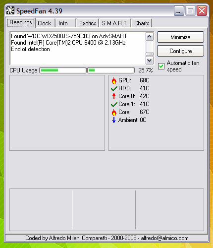

I downloaded SpeedFan (as the fan seems louder than usual) and get what you see in the image. Can anyone advise what a good next step might be?

by: seanpowellPosted on 2009-09-07 at 08:25:46ID: 25275664
Found some hanging wires that appeared to reconnect the sensor - but the disable seek option did solve the other issue. Thanks :-)
The temp keeps climbing - when do I need to get worried?
by: nobusPosted on 2009-09-07 at 08:54:15ID: 25275851
>>  when do I need to get worried?  <<   check the max temps for your model here :
http://www.hardwaresecrets.com/article/143
