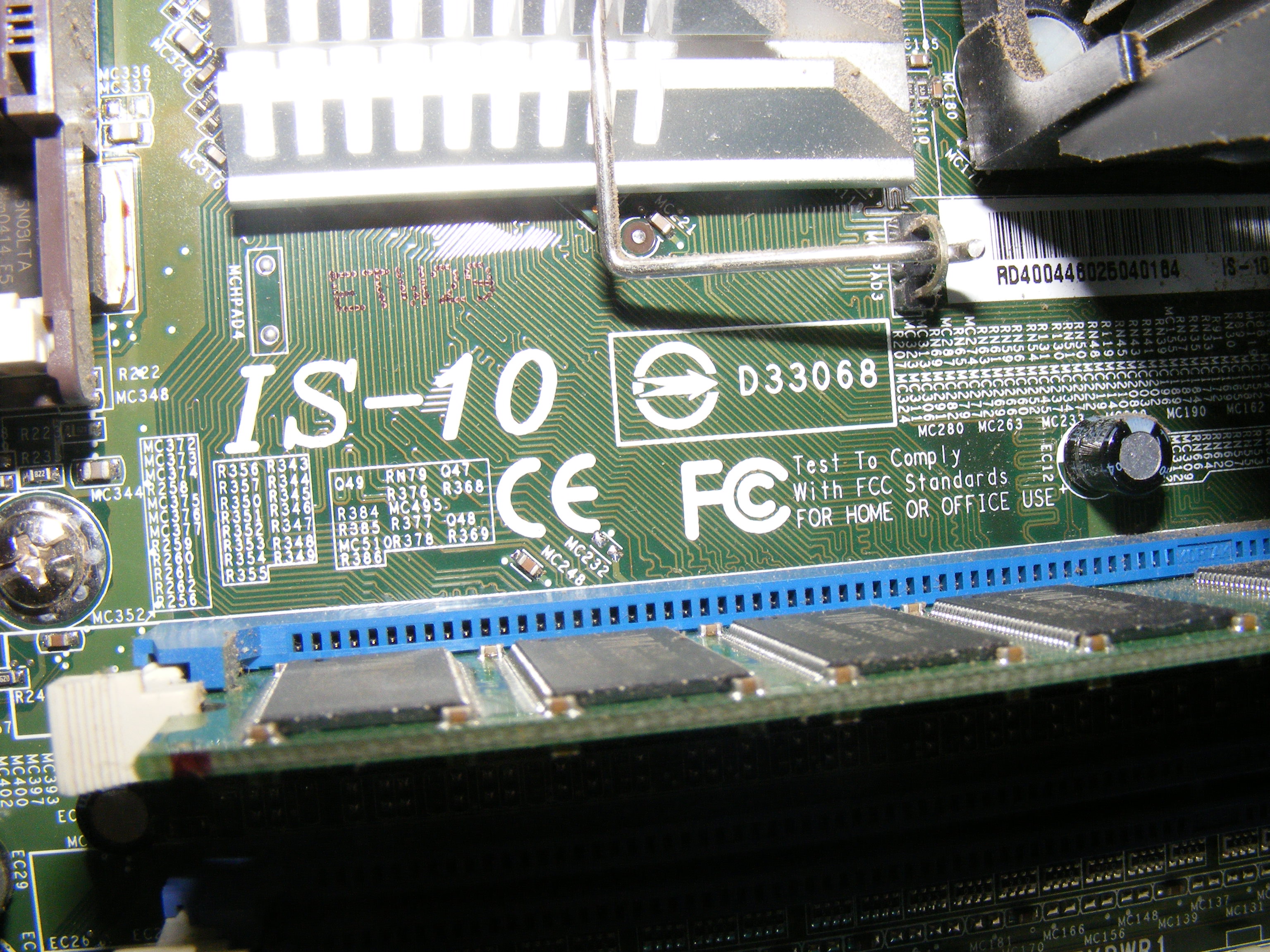

this number is unknown on the net.
Can you make a picture of the board, where the lettering is readable, and post it? then we may find more info
by: beefstu123Posted on 2009-08-19 at 15:44:23ID: 25138080
great, i'll get my camera from home at lunchtime and upload some snaps.
cheers nobus
by: beefstu123Posted on 2009-08-20 at 21:28:26ID: 25149155
is this pic good enough? otherwise, wat area did u want to see?
by: nobusPosted on 2009-08-20 at 23:30:42ID: 25149492
not sure, but it looks more like a serial number to me
nothing else is showing?
and i suppose you installed XP right?   then try Siw, and look what it says : http://www.lemonfiles.com/details.php?progid=9016

by: beefstu123Posted on 2009-08-23 at 04:16:27ID: 31617358
Perfect! thanks so much. that Siw program is brilliant. lead me straight to the manufacturer's website, www.abit.com.tw   thanks again nobus :)
