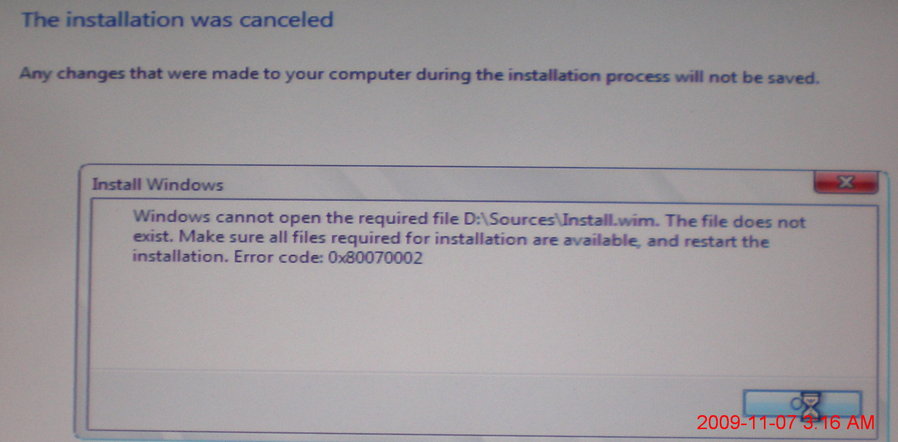

by: mikebesurfingPosted on 2009-11-07 at 10:56:59ID: 25767558
I have tried it 3 times now with the same result I even hooked up a newer clean dvd-rw drive to rule out the disc read error.  I get the    Windows cannot open the required file  D:\Sources\Install.win. The file does not exist. Make sure the required ........  Error Code  0x80070002
I have done Chkdsk /f 2 times but this time I did it it's hanging on 13 Percent of stage 4 of 5 at 80,000 for over a hour I just checked it and it made it past that is moving along.
If that does not help I will burn that disc agian at low speed and see if that makes any difference.
    • 338 KB
    Vista repair error right after hitting no to insert key
by: mikebesurfingPosted on 2009-11-07 at 12:26:18ID: 25767881
Ok I know I should of checked this before but the recovery disc I am booting with truly does not have that file the only thing in that Sources folder is a boot.win that is 116 MB. The install.win is no where on the disc
Any thoughts of a better disc or is there a trick.

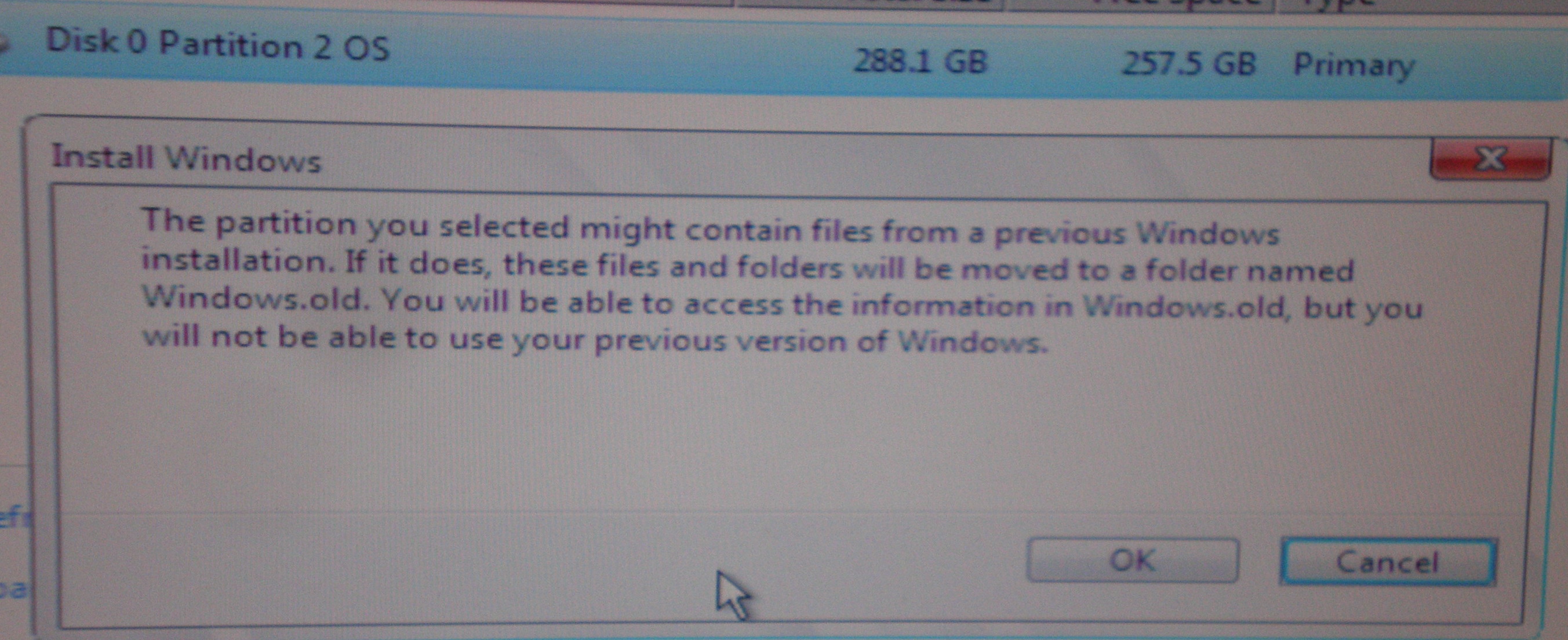

by: mikebesurfingPosted on 2009-11-08 at 10:06:20ID: 25771224
Ok I had not gone that far with it before, are you referring to the fact that it will move the old install to Windows Old .. That sounds to me like a clean install except that it moves the original install to that folder so you can access the data then its just a matter of moving the data back over? Is this correct?
Mike
Here is the screen shot of it .  I canceled it as soon as it started copying the files just to be safe for now.
by: nobusPosted on 2009-11-08 at 23:24:12ID: 25773926
it is not an error; it just tells you where you can find all the old data, so you can copy it back
