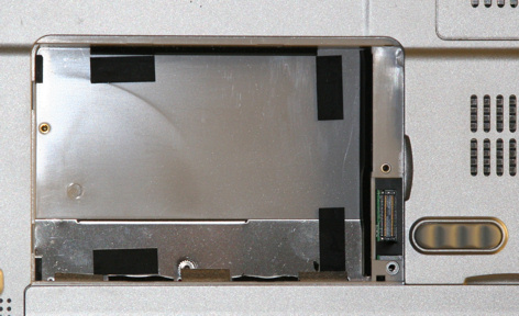

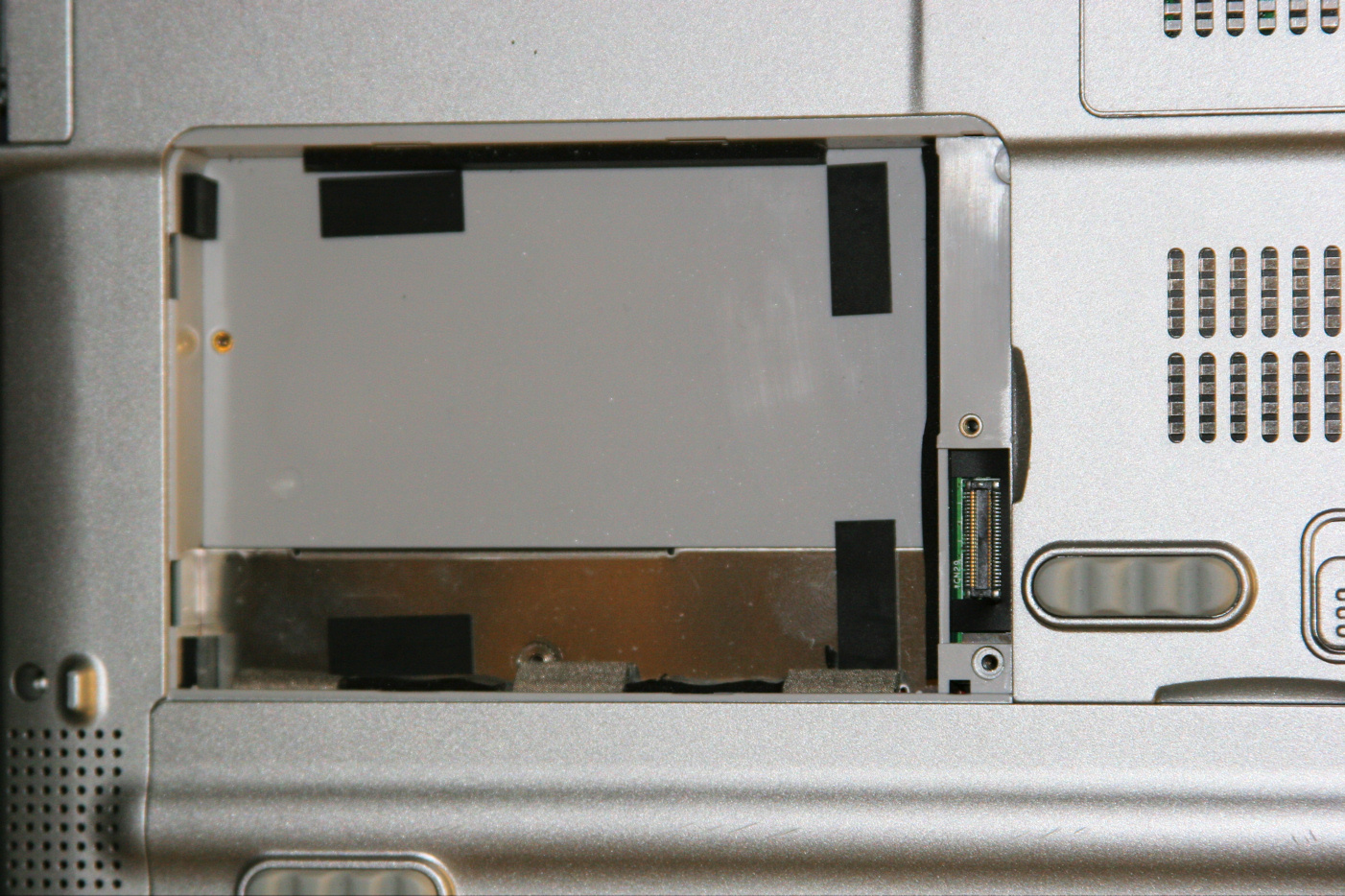

Have an MPC Transport2300 laptop, not sure what kind of hard drive connection it is using, looks like it will be an IDE to whatever this input is.  Any ideas on what type of connection it is? Thank You.

There should be a converter cable or bracket that goes from the HD to the port on the laptop.
Is it still attacjed to your old HD ?
by: skbryanPosted on 2009-01-13 at 12:46:40ID: 23367103
There is no converter cable or bracket, i would like to know which type of converter or bracket i would need. Thanks
by: travisgishPosted on 2009-01-13 at 12:58:55ID: 23367215
That model takes IDE drives, but you will need the drive enclosure for it. You may be able to find one on e-bay.

I might be wrong on this but it really looks to me like it is some sort of proprietary port replicator that is specific to MPC - I've never seen one like it before and my bet is that you'll need to talk to MPC on it.
by: skbryanPosted on 2009-01-13 at 13:06:43ID: 23367282
Unfortunately, MPC just recently declared bankruptcy, so tech support isn't possible.  It looks like an ordinary drive bay, maybe a little higher, and of course, the input near the top.  I dunno.  Was trying to find more info about it, but haven't come up with much.  9.5mmH 2.5" HDD, the HD in the spec sheet was listed as Hitachi 2.5" 60GB 7200RPM Hard Drive.  Thanks.
by: rbarnhardtPosted on 2009-01-13 at 13:07:41ID: 23367292
I believe it is a PATA. It is a new small connector commonly found on newer, small laptops.
by: skbryanPosted on 2009-01-13 at 13:11:27ID: 23367317
Hmmmm, that could be it, I recall seeing "pata" somewhere in my search for a solution.  Now, to find a replacement hard drive and cable.

Anyway, I'm not having any luck.  There is just a bay with no pin connects in the bay.  Looks like the drive would sit in the bay and attach by a ribbon connect on top.  I can't even find a drive that looks like it would fit.  If more photos would help, let me know.  Thanks!

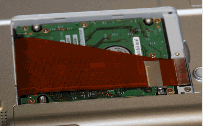

This looks to be the type. Found it on this page for a Sony
http://www.fonerbooks.com/laptop_9.htm
by: skbryanPosted on 2009-01-14 at 06:35:04ID: 23372961
So are you think that the drive does have the normal pins, but then has some sort of adapter that  fits on it with a ribbon cable that connects to the connection just outside of the bay?  What might that converter be called, I wonder and where the hack do I get one, and what is its purpose?  Good detective work, just going to read the details now.  Thanks!
by: sparkmakerPosted on 2009-01-14 at 06:46:58ID: 23373074
Do you have a hard drive caddy with this model, perhaps it has the connector integrated in it?
by: sparkmakerPosted on 2009-01-14 at 06:59:14ID: 23373236
If not integrated into the caddy then this would probably go under the name of a "Hard drive flex cable"
Usually made from mylex similar to this one from a Dell
http://cgi.ebay.co.uk/Dell-Latitude-D420-Hard-Drive-Flex-Cable-0HJ178_W0QQitemZ390017620922QQcmdZViewItemQQimsxZ20081217?IMSfp=TL0812171210002r2920
by: sparkmakerPosted on 2009-01-15 at 14:00:14ID: 23388311
I came across the proper name for this cable.
FPC(Flex-rigid Printed Circuit) cable.
by: skbryanPosted on 2009-01-15 at 14:36:01ID: 23388621
I am finding more and more of the cables, and I may end of buying several just to fine one that fits.  Thanks for everyone's help.  Still working on finding the correct part.  Thank you sparkmaker for furnishing the correct name.

Still looking for the part.  I do have a part number, but can't find it anywhere.  The part number is:
Platy HDD FPC
PN 08-20Z16031BSE
Career 27/0505
Very frustrating. . .
