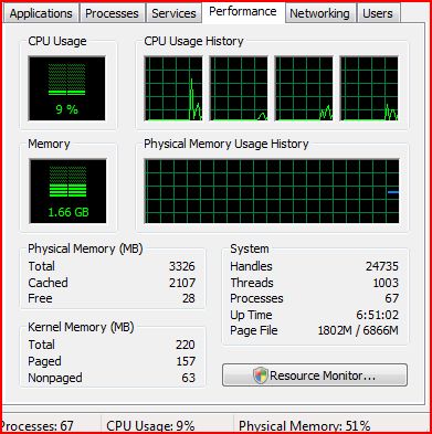

As shown in the pics, the Installed memory is 4GB, but only 3.25GB Total?  Is it a max that Vista Home premium 32 can handle?  Or is it something else?

by: bcolladayPosted on 2009-08-28 at 08:34:30ID: 25208737
I think a 32 bit system can only use 3.25 gb
by: gtworekPosted on 2009-08-28 at 08:34:44ID: 25208742
It's normal in 32bit systems. They never can handle entire 4GB...

by: gtworekPosted on 2009-08-28 at 08:37:42ID: 25208773
You may try to play with your bios settings (especially shadowing and memory remap) it may give you 3.5 or even 3.8GB.
But you never reach full 4GB.
Vista after SP1 "knows" you have 4GB in your hardware and display such information. But some hundreds of megs are not usable until you swith to 64bit.... It's PC architecture limitation.
