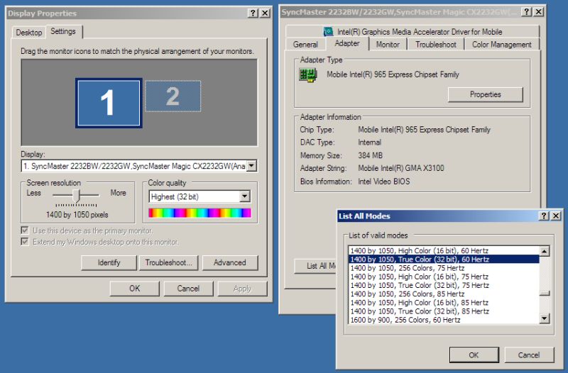

kaygroth2:  See attached screen dump of display properties

The GMA X3100 graphics adapter in the 965 Express chipset supports resolutions up to 2048 x 1536, so you should be able to use your native resolution with the proper drivers as long as the BIOS doesn't preclude this setting.    Just to be sure this isn't a BIOS issue, you might want to update to the latest A09 BIOS (which was just released on 16 April):  http://support.dell.com/support/downloads/download.aspx?c=us&cs=19&l=en&s=dhs&releaseid=R183451&SystemID=LATITUDE%20D630&servicetag=&os=WW1&osl=en&deviceid=13457&devlib=0&typecnt=0&vercnt=9&catid=-1&impid=-1&formatcnt=1&libid=1&fileid=250673
The slider on your posted Display Properties image clearly extends well to the right of the 1440 x 1050 resolution you're using => what are the additional options to the right of that?   If there are NO widescreen resolutions shown, then the issue may be a problem with the DDC communications with the monitor.   Try re-installing the monitor driver to be sure the video adapter "knows" that you have a widescreen monitor attached.

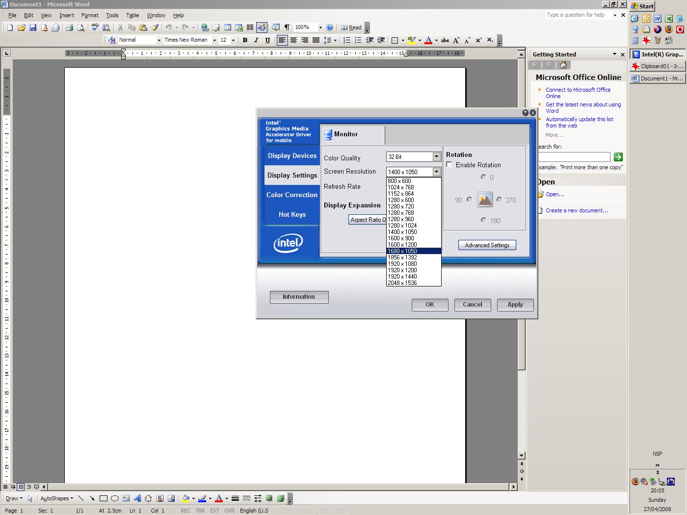

 - 1. taken at 1400 x 1050 and showing the intel graphics with allowed resolution shown in drop down tab.

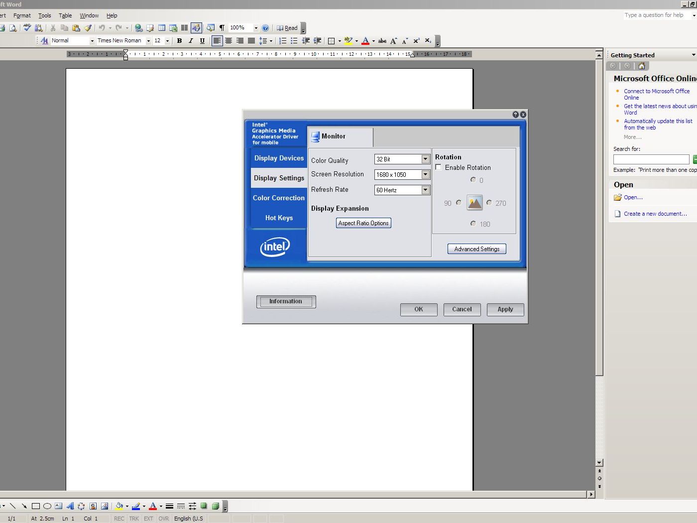

 - 2. taken when resolution changed to 1680 x 1050 and you can see my problem - the desktop extends beyond the monitor limits.  This picture was created by cropping the selection at 1400 x 1050 px.  So although the information is displayed at 1680 x 1050 there are 280 px outside of the monitor width.

I cannot belive that I hadn't tried this:  set resolution to 1680 x 1050 and then used the monitors auto adjust feature.  All solved!
