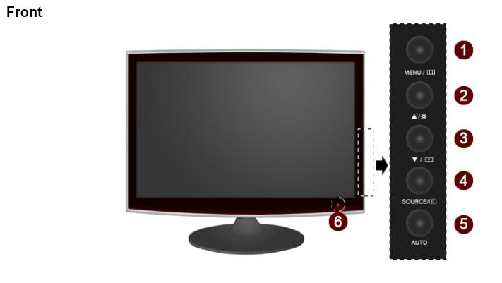

by: darron_chapmanPosted on 2008-12-03 at 06:58:11ID: 23086452
You need to press the source button on your monitor to switch to the DVI input.
by: SeoulkidPosted on 2008-12-03 at 07:30:23ID: 23086836
I do not have a source button on the monitor.  The Monitor itself changes from digital to Analog.  There is only an information button on the menu screen of the monitor and it doesn't allow a change to be made.
by: darron_chapmanPosted on 2008-12-03 at 08:00:29ID: 23087190
This picture is taken directly from the T220 manual.  The buttons are located on the right hand side of the monitor (you have to turn the monitor to see it).  It's button number 4.
by: SeoulkidPosted on 2008-12-03 at 08:12:09ID: 23087309
Wow, I was fiddling with those buttons last night and I didn't see that button.  I will check back with you tonight.  Thank you for your help so far.
by: SeoulkidPosted on 2008-12-03 at 14:12:20ID: 23090837
Okay so I checked the source button, and it did change the monitor to Digital mode. The problem is that the monitor says check cable connection on it (obviously because the VGA cord is in the computer)  I tried to switch it while in that mode, however it didn't work.  It just stayed black.
