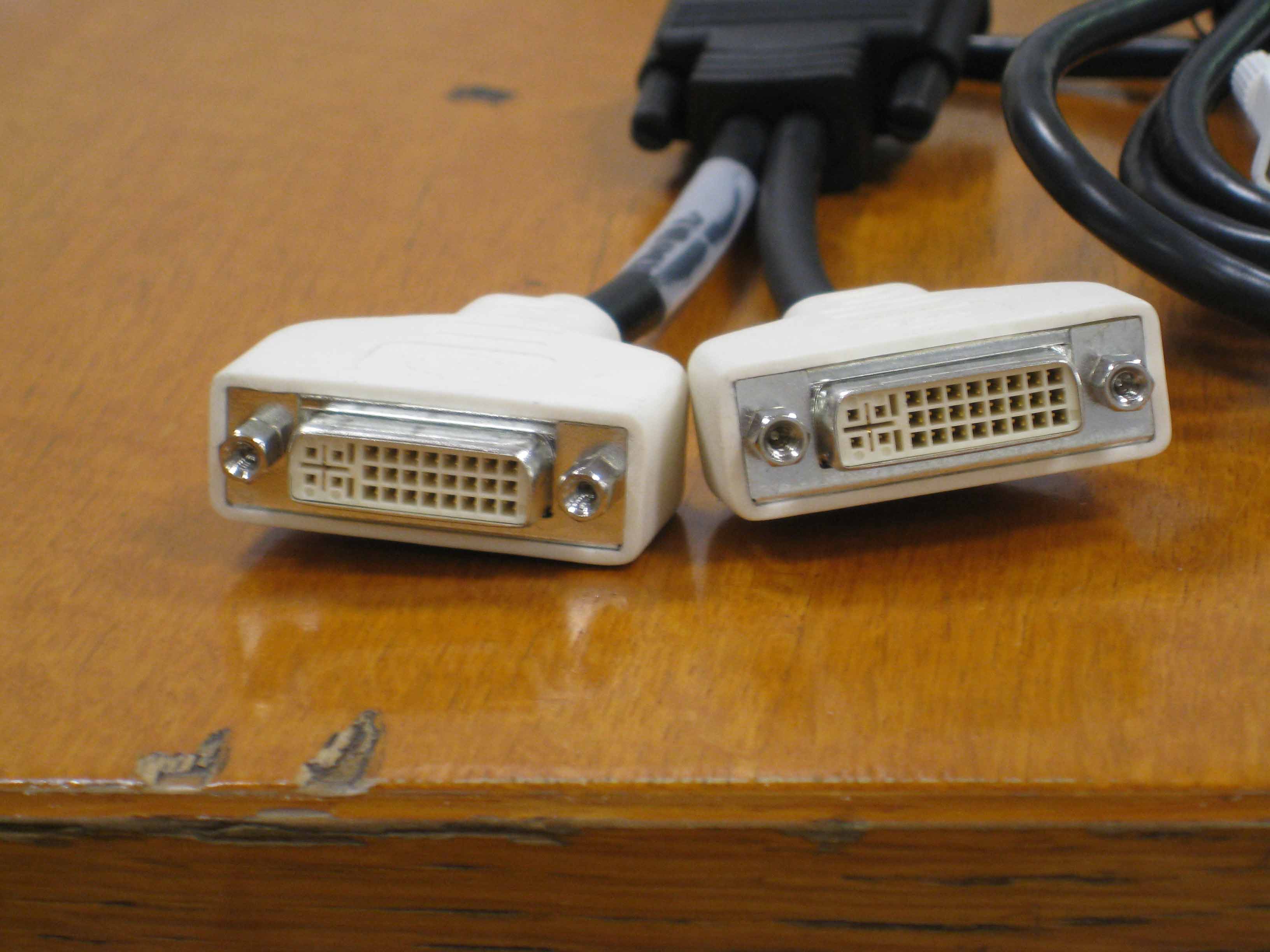

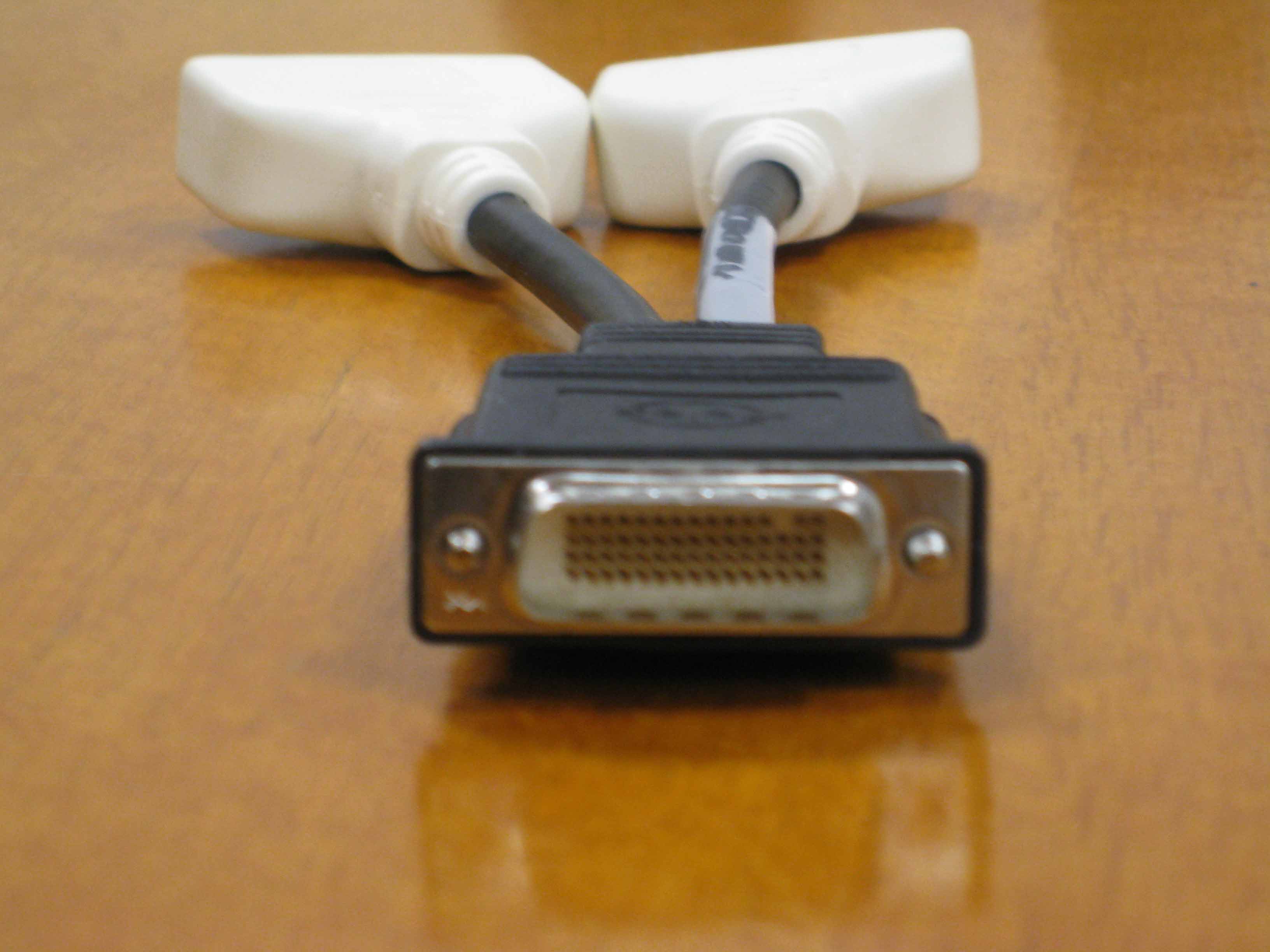

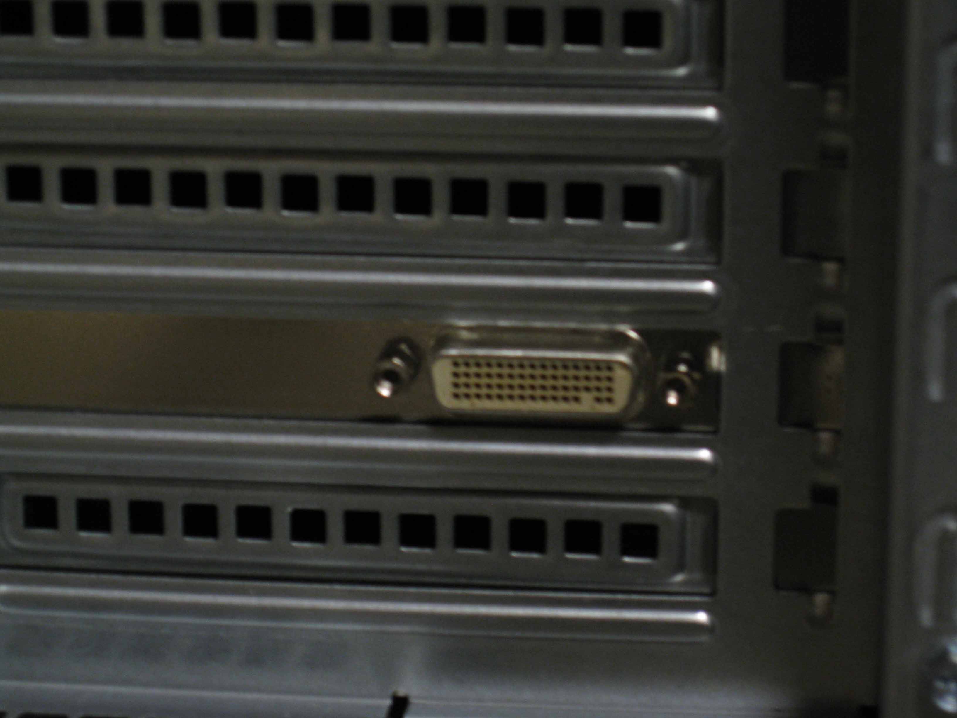

I've got a Dell system with an Nvidia card in it (I'm not exactly sure what the model for either is). The Nvidia card has a single DMS-59 connector on it, and I have twin Dell 1708FP displays, running Gentoo Linux. I also have two splitters: one that splits the DMS-59 into two VGA signals, one that splits it into two DVI signals.
If I connect the displays with the VGA cables, I get both displays up. If I connect either one or two displays with DVI cables, neither display works... same if I connect only one display (for which I still have the splitter in place, since I don't have a DMS-59 to DVI adapter, just the splitter). I'm using single-link DVI cables.

by: CallandorPosted on 2008-12-12 at 17:49:35ID: 23162538
If the monitors expect DVI-I and you provide DVI-D, that may keep them from displaying anything.  Check which DVI the splitter is connecting with: http://en.wikipedia.org/wiki/Digital_Visual_Interface

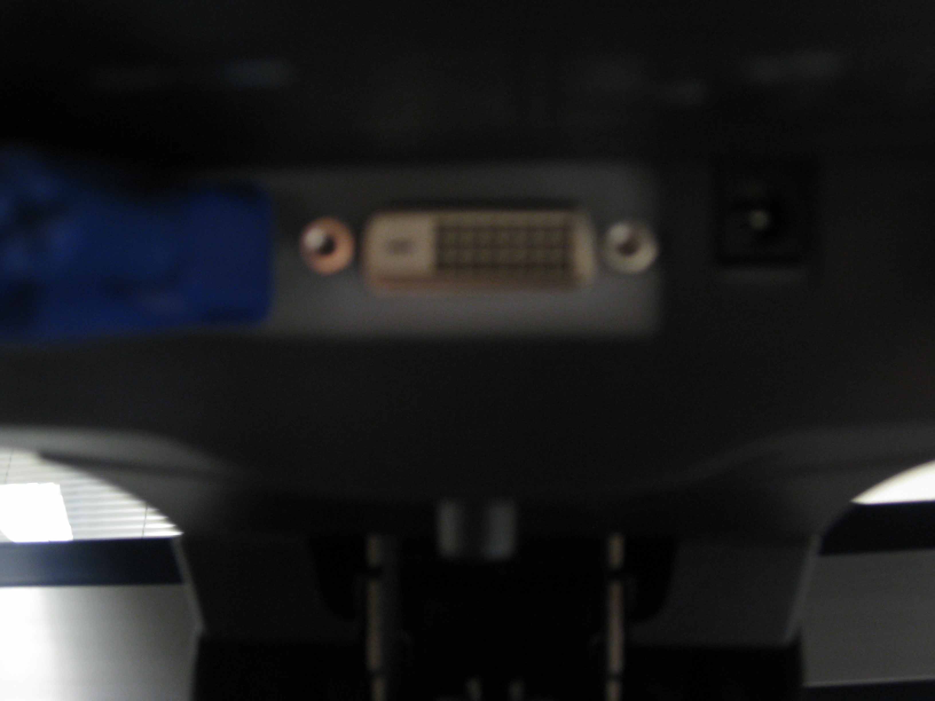

In any case, my displays have DVI-D connectors (and separate VGA connectors, the ones that work), and my cables are DVI-D (single-link). I have pictures of all connectors, although the one of the connector on one of my monitors is pretty fuzzy... You can still see that it's a DVI-D connector, though. As for the splitter, I'm not sure... it's DVI-I, I suppose, but since it's connected to a DMS-59, it should be transmitting a digital signal for the DVI-D cables, no?
So here's my understanding: DMS-59 produces a digital signal, DMS-59 to DVI-I splitter transmits a digital signal, DVI-D cables transmit a digital signal, DVI-D connectors on monitors receive a digital signal. Except they don't seem to receive ANY signal, either when I let them autodetect that there's a DVI cable plugged in, or when I select that a DVI cable is plugged in.
