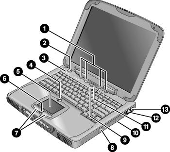

by: sparkmakerPosted on 2008-09-08 at 07:51:43ID: 22417935
There should be a  connector for attaching an ethernet cable(LAN-Local area network)
the modem should also have a connector for a telephone line.
The position of these connectors are shown in this picture as number 12(modem) and 13(LAN)
by: artismobilePosted on 2008-09-08 at 09:39:18ID: 22419102
I have both the modem and LAN so the second suggestion will work for me. Thanks for the picture.
by: sparkmakerPosted on 2008-09-08 at 09:46:55ID: 22419176
No problem, I saved typing a thousand words if the old adage is correct.(A picture is worth....)
