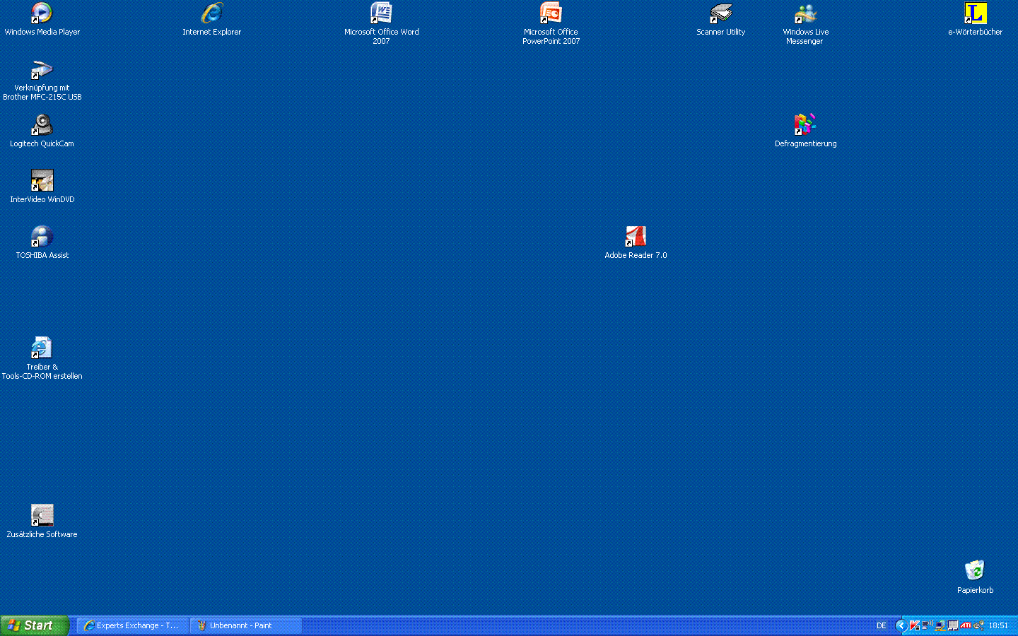

white lines appear on the desktop, without any further damage
Asked by: rusdemezale
no detectable damage observed.
but how can I cure ít?
gif image in attachment.

by: nobusPosted on 2009-08-25 at 00:50:45ID: 25175241
i don't see white lines...
you can also try another resolution.

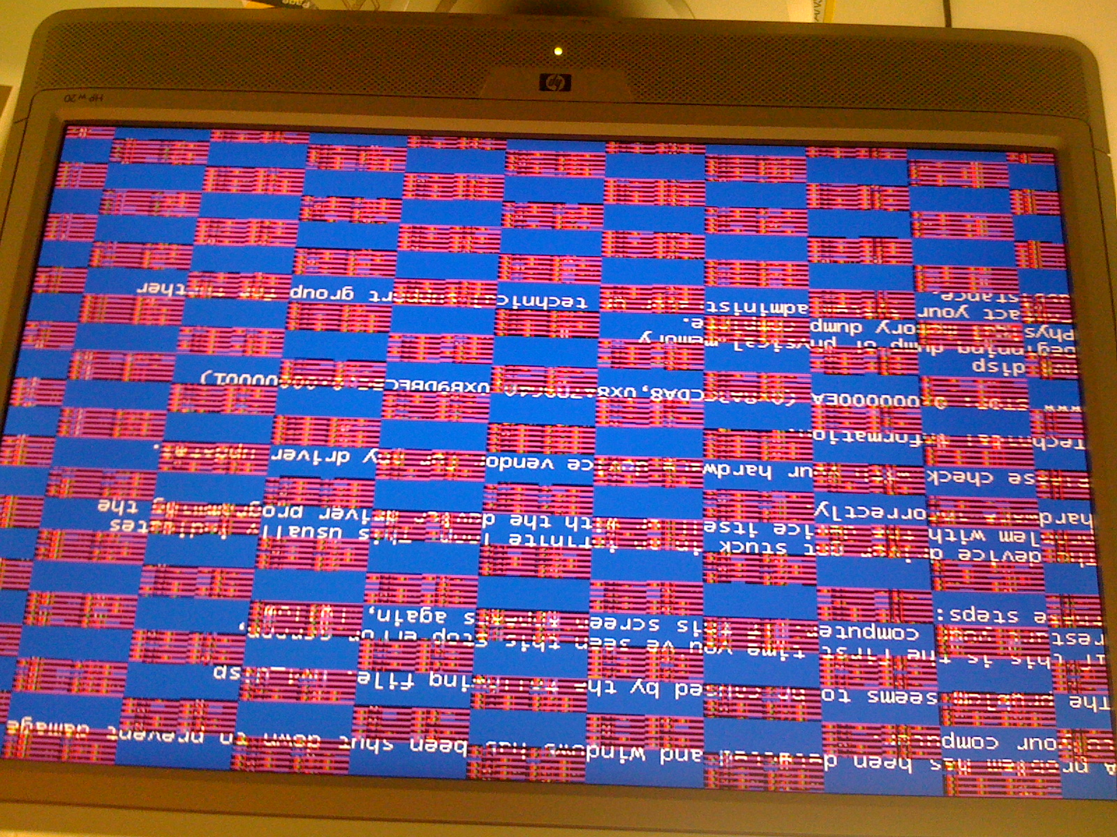

by: rusdemezalePosted on 2009-09-21 at 02:02:23ID: 25381187
I did nothing, but I did not detect the new white lines for a while.
but suddenly yesterday, the monitor crashed.Hardware Failure.infinite loop etc...
please have a look at the picture attached.
by: nobusPosted on 2009-09-21 at 03:55:02ID: 25381638
tets it on another pC - this will show if the monitor is bad, or the video card !
by: tinystechPosted on 2009-09-21 at 07:52:02ID: 25383475
That is a video card, but it could be just a driver.  Does the screen appear normal before you get that screen in the picture?

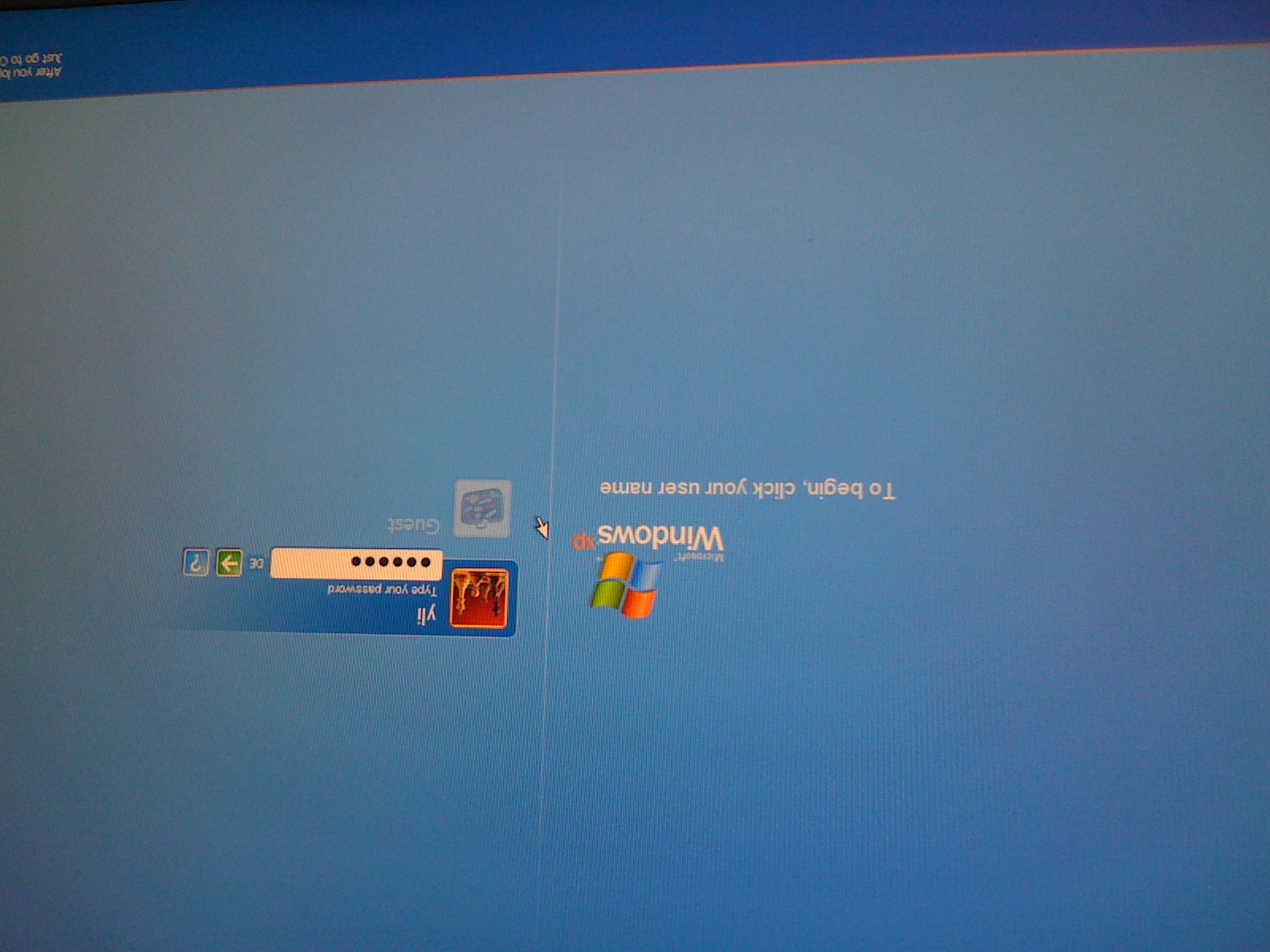

by: rusdemezalePosted on 2009-09-21 at 10:49:31ID: 25385519
hi tinystech,
yes login screen is viewable normally. so not a hardware issue but windows kernel driver ???
by: rusdemezalePosted on 2009-09-21 at 14:39:15ID: 25387896
the logon screen is ok-viewable, but as soon as I log in or after having logged on, while trying to do sth., open browser etc., it blurs a while and then monitor becomes black, going to sleep. no reaction. I have to then restart the computer!!!
if I otherwise restart in Safe Mode, no problem.(that is what I am doing at the moment)

by: rusdemezalePosted on 2009-09-23 at 02:48:10ID: 25401256
@nobus:
I dont have any other computer to test the monitor, so I downloaded the KNOPPIX Image, burnt to a CDROM Disc and booted therevia.
at first everything was working fine, but suddenly it started blurring in KNOPPIX.
and the monitor was not reacting to any mouse clicks, although mouse was moving around...
so most probably Videa Card is corrupt, and must be renewed!!!
thanks for the help to everybody.
