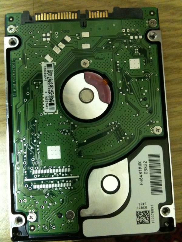

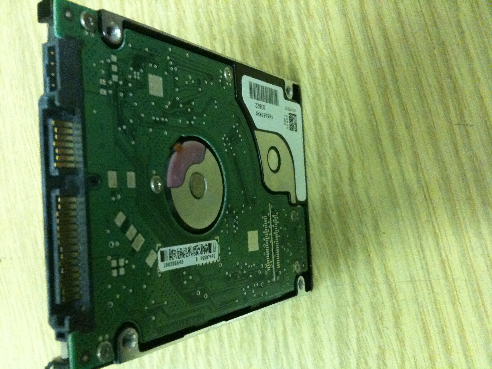

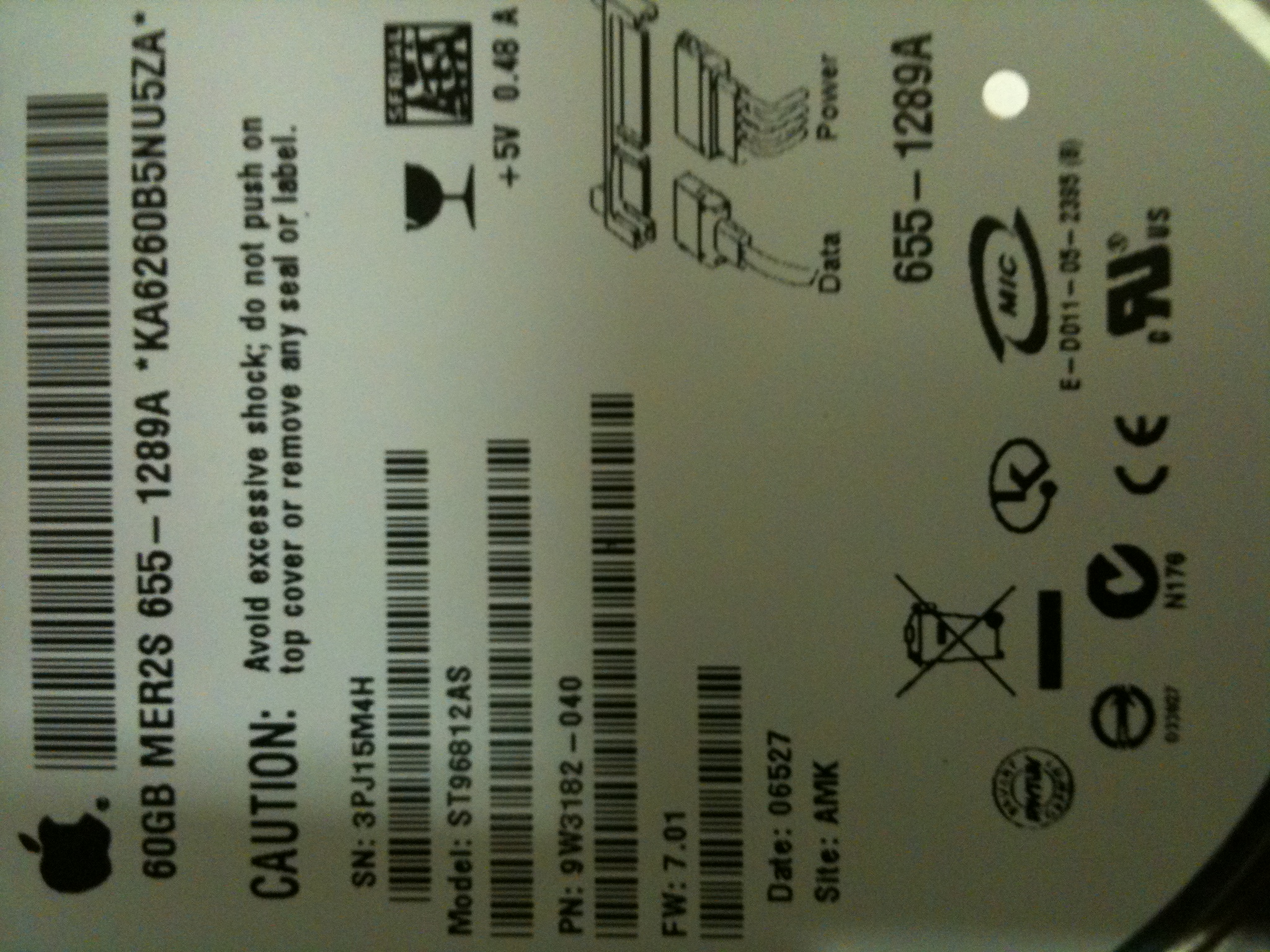

i replaced a bad seagate 60GB SATA hard drive (sn: 3PJ15M4H) (model: ST96812AS) in a macbook. On the bad hard drive is a very important file that i need to retrieve for the client but the drive is not mounting it will  spin for a moment but will not mount. we don't have the funds to send it out, starting quotes are ranging around $500 to $600 level 1 retrieval process, i have attached 3 images of the drive for your review but the audio file extension (.m4a) of the sound it makes will not upload if you wish to hear it i can email it to you at your request. My question is are there and utility programs that will repair the drive via usb or sata connections or allow access temporarily so i can extract the file, i was thinking about replacing the back plate or circuit board with an identical board to see if that might help or are there any other methods i can try or anything i can do. Code word - HELP!!!

no utility program can possibly get a stuck bearing to turn, or a head crash to repair itself.   If you can, please post the sound it makes.  Some problems are obvious based on the sound, if it is a motor, bearing, or something mechanical that can be fixed, you will pay less ... conversely if it sounds like a head crash, then pay the money or lose the file.
Note, you run risk of making problem worse every second the drive is powered up.  (Don't kill the messenger, just giving you the cold, hard facts).
Does the BIOS see the drive at all?  This is also helpful to know and pinpoint problem.

by: dlethePosted on 2009-10-14 at 09:51:27ID: 25572543
Going back to what I said before, all of those software programs won't do squat if there is hardware issue.  The software will do things like reconstruct files from inodes, rebuild partitioning, reconstruct RAID, skip over bad blocks and do best it can
but ...
if your disk isn't spinning at proper RPMs, or the circuit board is blown, voltage is off, heads are damaged, media is damaged, then it is a waste of time.  Click-click noises almost always mean hardware fault, with rare exception that it is a power supply.  So as strung said, if you want the data back enough to pay $500+ for it ... then just ship if off, most all recovery companies will give you a free quote.  Powering on the disk can make recovery impossible, or just a lot more expensive.     Your decision.
