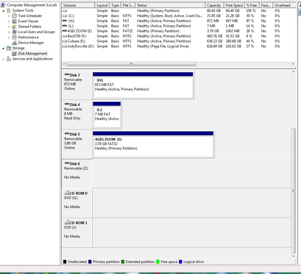

by: Pete_ZedPosted on 2009-09-20 at 21:02:02ID: 25380237
Does the drive appear under Disk Management? It may be a permissions problem or as simple as a drive letter missing.
Right click COMPUTER and choose MANAGE. Click on disk management. Does it appear there? Does it have a drive letter?
by: jodyfaisonPosted on 2009-09-20 at 21:30:01ID: 25380324
No I just double checked. I have so many drives, and virtual drives, and re movables, that it had occurred to me that it just couldn't find an available letter. But it doesn't show an eSata anywhere on the graph or table.

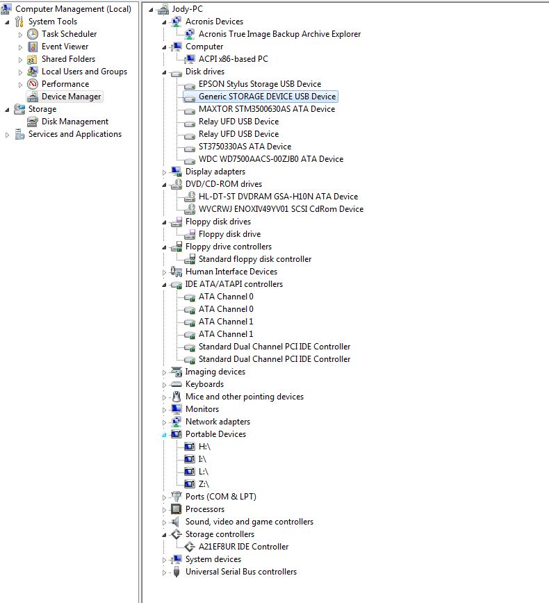

by: grayePosted on 2009-09-24 at 08:26:15ID: 25414344
So, show is what *is* in the Device Manger under the "Disk Drives" and "Storage Controller" sections
by: jodyfaisonPosted on 2009-09-24 at 09:56:34ID: 25415400
Yes, I thought earlier I should send a screen shot, and maybe you can find it. I'll get some right up here. thanks again.

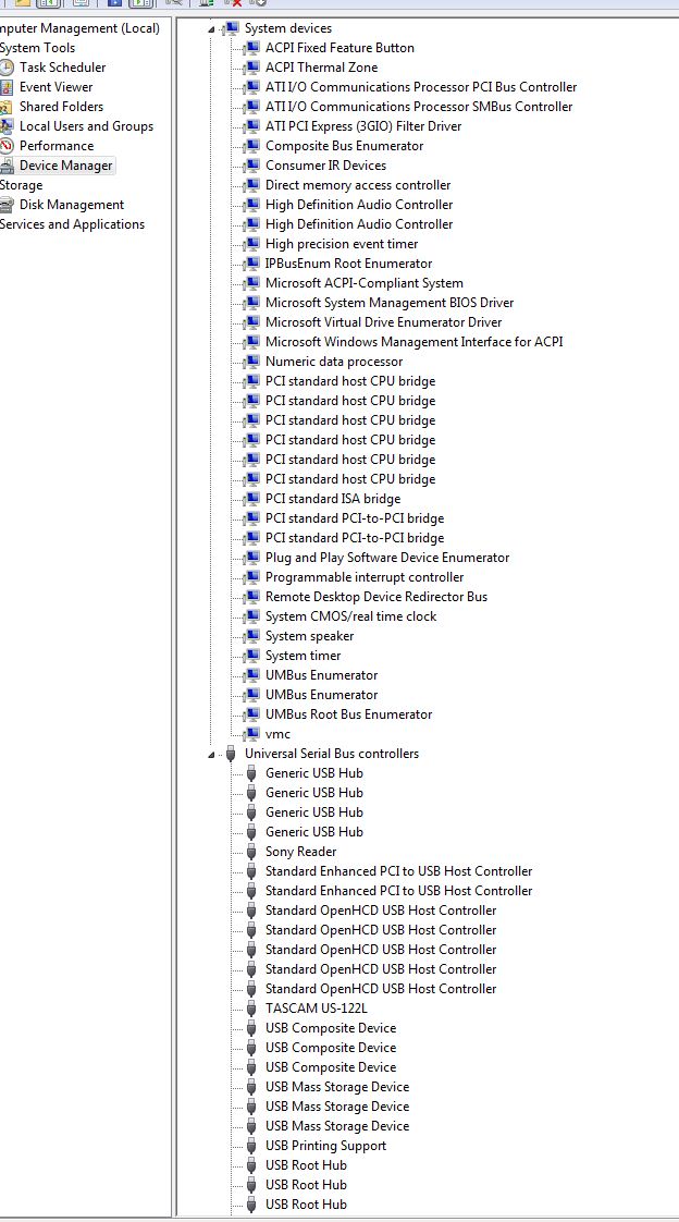

by: jodyfaisonPosted on 2009-09-24 at 10:14:50ID: 25415550
Ok, on the 2nd device manager shot,  two usb root hubs are missing from bottom of screen. Other than that, I think you see everything in the 3 shots, unless there's another console I'm not aware of.
 I don't know what that SCSI CD-rom player is in device manager. I assumed it was from Daemon lite, but I don't know. Could it be an eSata in disguise.?
by: centervPosted on 2009-09-24 at 21:20:40ID: 25420009
Win7 will not show empty root hubs by default.
I believe the setting is under folder views.

Also, go to system properties, manage, storage  and see that your drive has an assigned letter.
by: jodyfaisonPosted on 2009-09-25 at 00:01:58ID: 25420550
Ok, I've been working it here awhile but I'm a little lost. Where is the "folder views" you refer to?
I've unplugged all my usb misc and down to my 3 hard drives. I can find storage under computer management. But nothing there, and still nothing in STORAGE device manager. I do see traces of it, showing up as  missing, with two drive letters., This

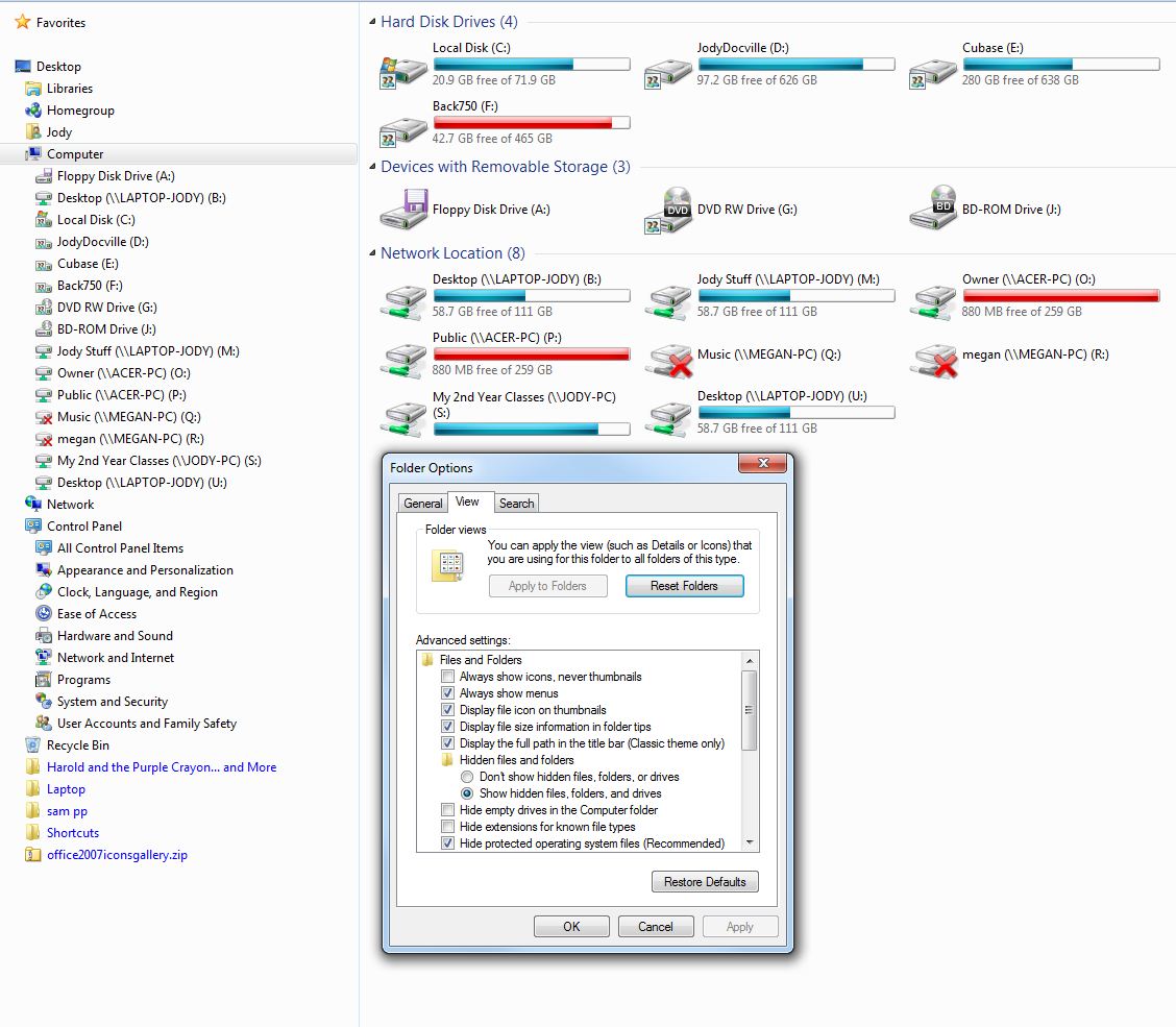

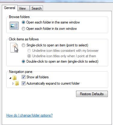

by: centervPosted on 2009-09-25 at 05:43:13ID: 25422353
Computer/organizer/folder and search options/view/hide empty drives in computer
or type folder in search box, click folder options/view
by: jodyfaisonPosted on 2009-09-25 at 10:55:10ID: 25425413
Ok, cool. that's where I thought you were, but not sure....
Sad to report though, no luck.
I tried re-installing the driver software with the exe from Seagate. It thinks its installed and would only repair, modify or uninstall. It has a utility feature though, that doesn't recognize an e-sata drive

    I set the option in the folder view dial, opened the veiw, then went back and oped thedialog agian for showing...
    • 36 KB
    Set this one too
    Set this one too
