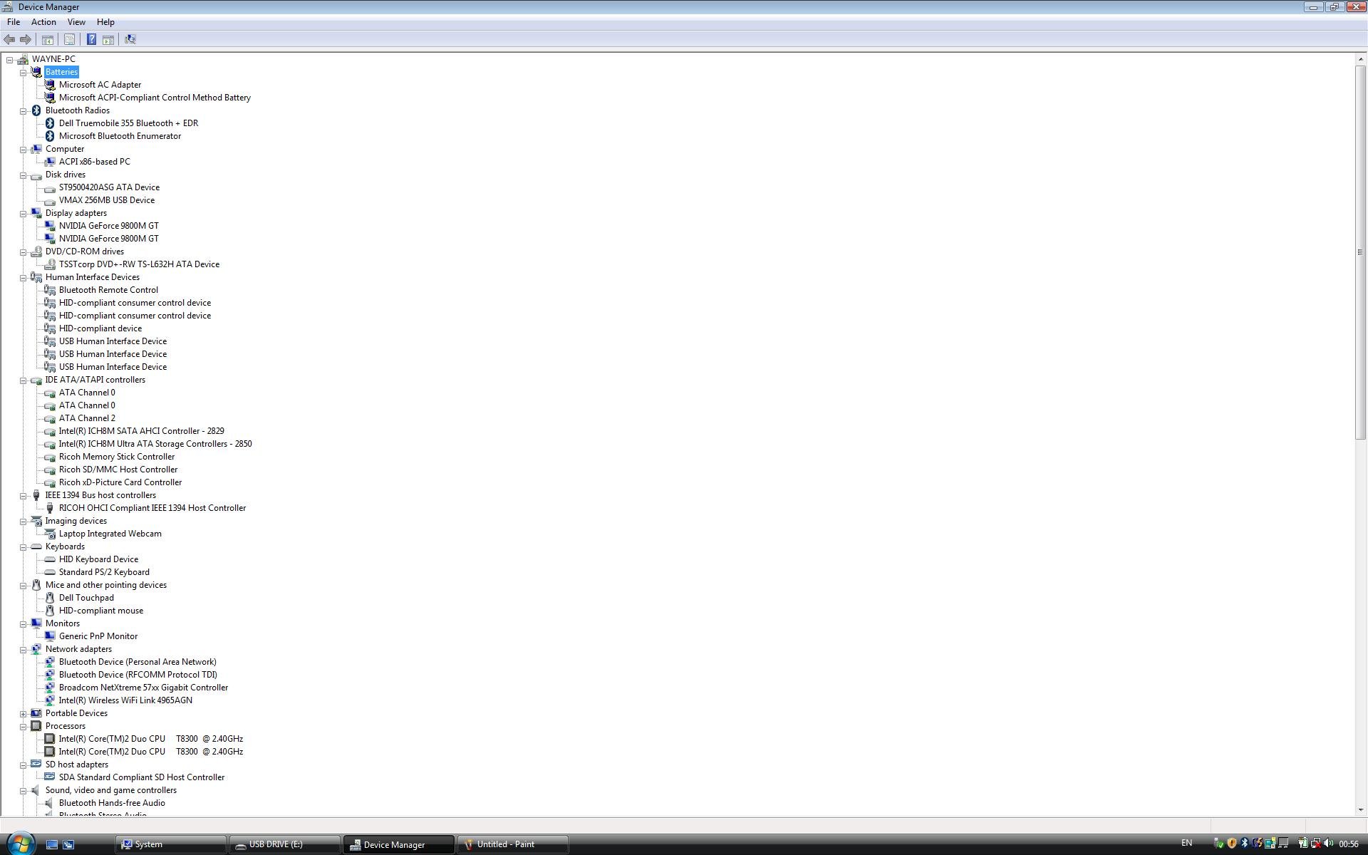

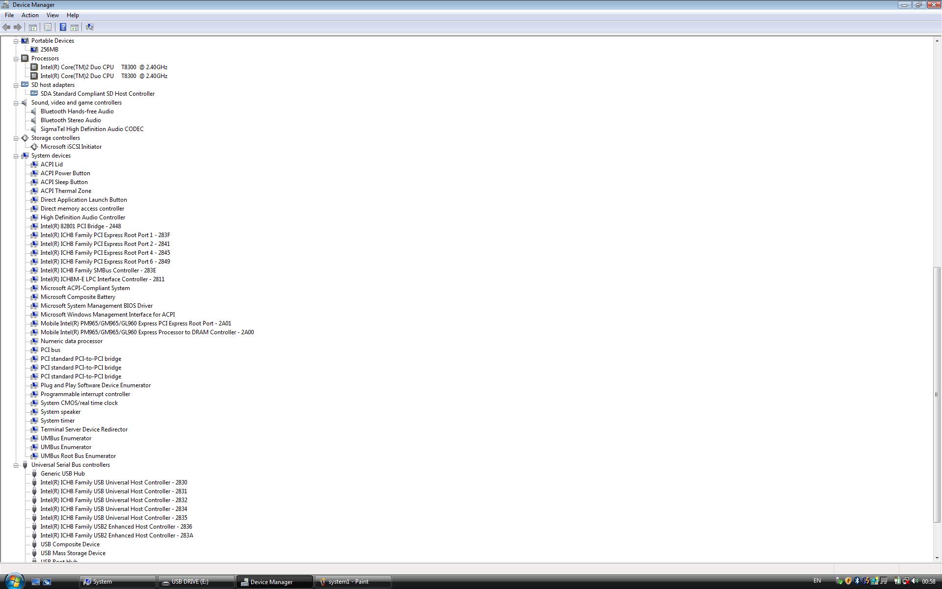

by: jarvtPosted on 2009-08-20 at 17:15:29ID: 25148182
No luck unfortunately. I followed the directions to a tee and still cannot exit out of MD. And to cap it all off, one of the LEDs has turned a flickery orange colour.
I'm attaching screenshots of the device manager. There were no exclamation marks.
by: GeekTechLabPosted on 2009-08-22 at 23:40:39ID: 25161564
Hello,
Well, in this case, you have followed all the procedures to achieve a perfect Windows reinstallation, but as I mentioned before, there was still the problem about the incompatibility, unfortunately, MediaDirect 3.x is not compatible with nVidia Geforce 9800M GTX, this doesn't mean that it will not work at all, but there will be some problems when running, and this is probably why you're experiencing this issue, even after installing Windows following all the proper steps.
And about Mediadirect 4.x, as far as I know, it is only fully compatible with certain Studio systems, because it does not use a partition. If you have any other doubt or question, feel free to ask me :)
