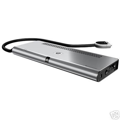

I have a client where monitor doesn't have a red color.  Only blue and green so the picture come as deadly bluish.  Sometimes red comes back but most of the time not.  Obviously my first was a monitor failed so I ordered a replacement from Dell.  Dell sent a new monitor, they pluged it in but same thing..
Monitor plugged into the HP laptop tx1000 via that external docking station, I attached the picture.  I tried wiggling wires, moving the HP port, and turning the monitor on and off.  Nothing helps.
Is it possible the dock it going bad or would it be the laptop itself?

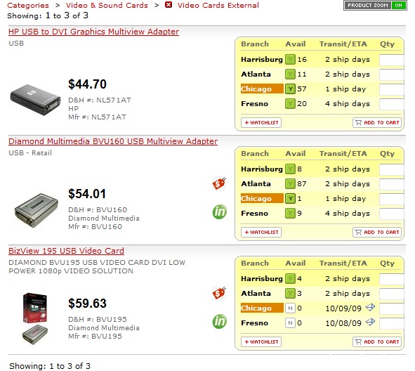

USB Graphics Card:
http://h10010.www1.hp.com/wwpc/us/en/sm/WF06c/A10-51210-332469-332462-332469-3913299-3913300-3913303.html
$59.99
by: Tiras25Posted on 2009-09-30 at 10:57:25ID: 25461490
Looks like the motherboard is way too expensive.  Its not worth it.
The USB graphic card has a DVI connector only.  I wonder if there any that have VGA's also.
by: PatelBhavinPosted on 2009-09-30 at 10:58:55ID: 25461503
The Second One Is VGA and DVI.
by: PatelBhavinPosted on 2009-09-30 at 11:02:54ID: 25461539
I attached the cards my vendor has, these are the cards I know of.
