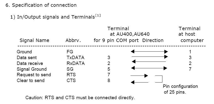

I need to be able to quickly fabricate a serial cable with the following configuration (see attached image).
What is the easiest way to do this?  I have a computer hardware store across the street.  I have some experience with soldering, but I would rather avoid that if at all possible as I don't want it to be my fault if the cable doesn't work or if it goes bad, since cable making is only a hobby of mine, I am not a professional at it.  This matter is very urgent so polish is not required nor requested in your replies.
What kind of cable or parts should I start with?
What steps do I take to configure it properly?
What is the best way to test it?
Another requirement from the spec is (paraphrased): Do not use any terminals other than No. 2,3,5,7, or 8 for any other purpose
