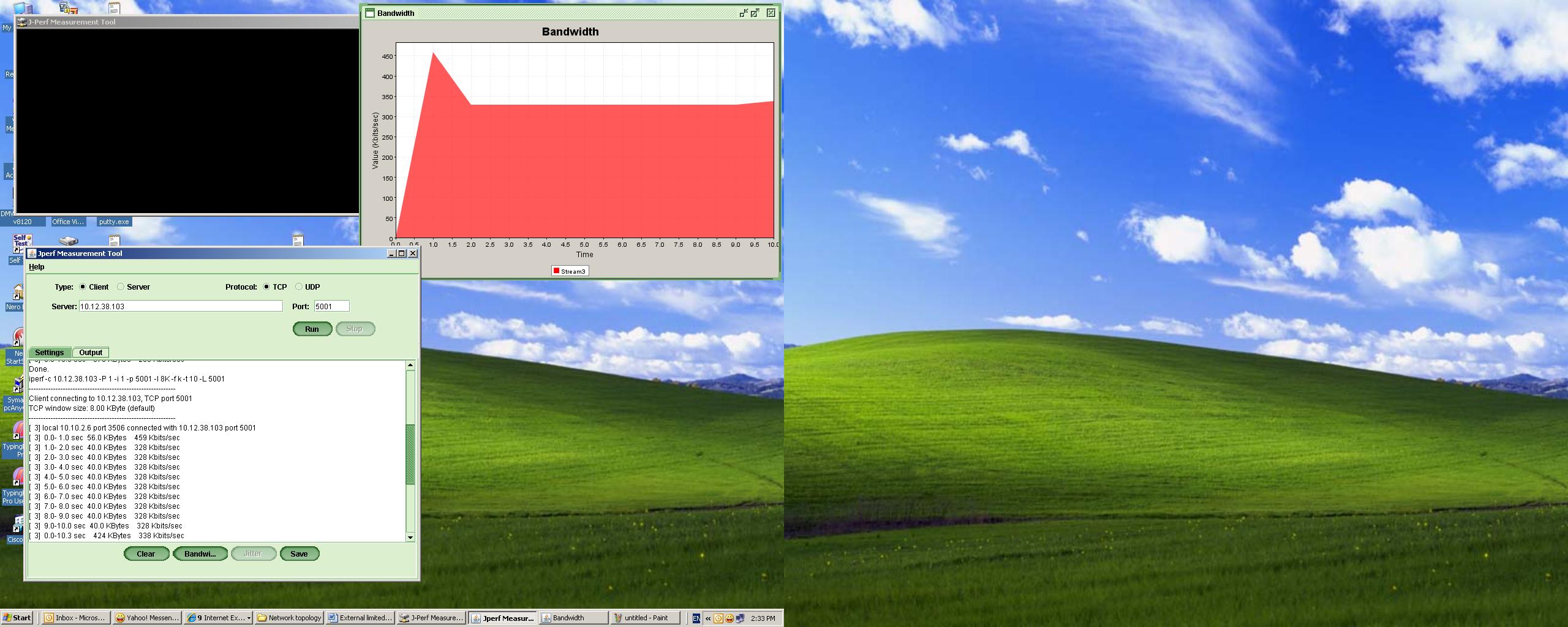

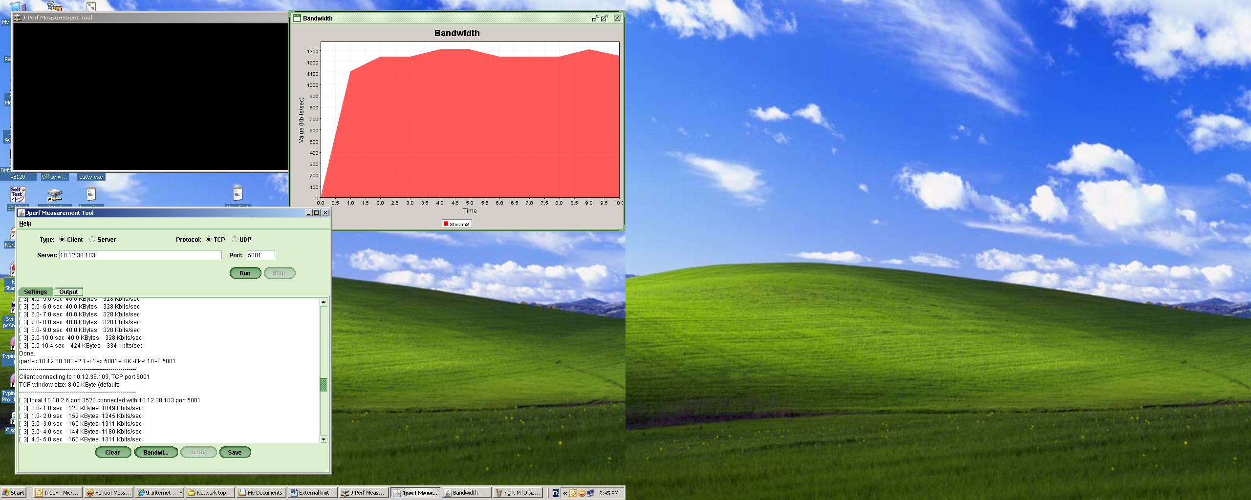

by: lrmoorePosted on 2008-09-28 at 10:56:16ID: 22591986
