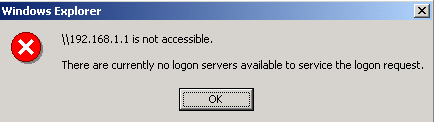

I have given the default gateway as 192.168.1.1 which is my Laptop's IP. Now I am able to access the shared folders on my desktop. But not shared folders from laptop on the desktop. When I try to access the shares on the laptop from desktop, I am getting the attached error.
One more question, if everything works fine... only file sharing is possible using peer-to-peer (by crossover cable) or can I access the other machine as it is connected through a LAN using hub/switch? Because I want to access the SQL Server installed on the desktop from the laptop. Is it possible using the crossover cable connection?

by: Srinivas_VengalaPosted on 2009-01-06 at 18:25:33ID: 31529093
As my Laptop is my company's domain, whenever I try to access my laptop from desktop (using a local account), it is trying to connect to a logon server (may be the domain controller) which is not available when I am not connected to my company's domain. Hence, it is giving error when connecting to my laptop from desktop.
