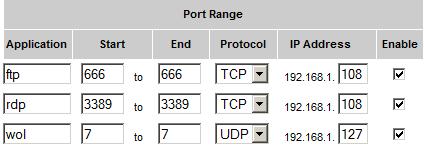

I have a linksys WRT54G version 7 (firmware: v7.00.4).
My home computer is configured so I can boot it with a wol magic packet.
This works great in the LAN, but when I send the magic packet from the internet, nothing happens with the computer.
I am sure the port forwarding configured on the router is correct. Since it is impossible to use static ip-adresses on the router, I send the packet to the broadcast-address for my LAN 10.0.0.127.
I think the problem is that the router does not support ip directed broadcast, and since there is no 3rd part firmware for version 7 of the router im kind of stuck right now..
Does anyone know how to get WOL from WAN to LAN working with linksys WRT54G version 7?
Cheers, ee.
