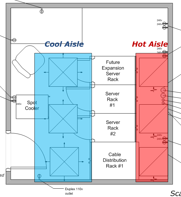

Experts,
I have a server room thermostat placement question. Attached you will find a screen shot of a visio drawing of our new server room that will be built. Where would the best location be for the themostat to be placed in this room. The server room will have dedicated ac with hot and cold aisles. The spot cooler in this drawing will not be there and in the cold air aisle there will be one vent in front/above the servers and one hot air return behind/above the servers instead of the 6 in the image.
Thank you for any help you may beable to give.

You'll want to have the thermostat somewhat away from the aisles as you do not want the direct air temperature to affect what you really want in the ambient temperature.  You probably will end up stacking shelves/objects in the upper-right open space of the room, so don't put it there or you could end up obstructing the thermostat.
by: MaerosPosted on 2009-09-02 at 18:59:38ID: 25247317
I'd highly recommend you also speak with the HVAC tech who is setting up your AC as well.

The HVAC/installer wants to place the thermostat on the wall when you first walk through the door on the left. It would be in the location of the spot cooler in the drawing.
ChiefIT does having one in each rack require any special setup?

I know about temp sensors and monitors, what I was referring to is the wall control thermostat that controls the main ac unit. Would this need to be mounted in the rack or would it stay on the wall where they want to put it and if so is that location a good location?
Thank you everyone for participation.
by: ChiefITPosted on 2009-09-04 at 01:56:17ID: 25257766
OHHH, silly me:
Pretty much anywhere is fine. I like mine inside the door for easy access.
It will be used to control the temp in the room, and is manually adjustable, right? So, you can adjust it after the fact.
by: MaerosPosted on 2009-09-04 at 14:03:27ID: 25263316
Also when you can, make sure the door to the server room is closed.  Typically server rooms are/should be cooler than standard ambient around the rest of the office, and having the door open will make the AC work harder unnecessarily.
by: MaerosPosted on 2009-09-04 at 14:05:04ID: 25263329
The HVAC tech's suggestion is pretty much consistent with what I was thinking of a good location.  Just make sure not to stack too much stuff around it if you intend to use that wall for boxes/towers/equipment.
