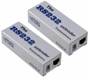

I have POS application on Touch screen.  I would like to send some orders to back kitchen area over the limit of the com port maximum distance.
My OS is Windows XP Pro and newwork configuration is DB9 to RJ45 and RJ45 to com port printer DB9(Kitchen printer).
Is there anyway to extend or enhance the signal?

by: BitsBytesandMorePosted on 2009-09-09 at 04:27:34ID: 25290013
The extenders above in the picture claim to allow you 3300 feet:
".......RS232 Extender Cat5 is a low cost hardware solution that will extend your RS232 (serial / DB-9) control up to 1000 meters (3300 feet) using standard Cat5 / Cat5e / Cat6 UTP cable. It provides remote access and control of any RS232 protocol device...."
by: avcontrolPosted on 2009-09-09 at 06:29:12ID: 25290981
RS232 is easy can be converted to RS422/485- up 1000 feet.
There is a lot of wireless solution for it as well, just google by "RS232....RS485 converters", using same cable.
RS422/485 is native solution, and a lot of RS232 devices, can have option sent it out RS485, not just RS232.
CAT5 extenders, is a substitution , and therefore can not be expected work perfectly well in some situations.
I tryed back 8 years, using RS232 go up 100 Feet(not suppose to), it seems to work, never try 150 feet.
But if there is no interference around, and you use 18/3 wire, you can try , and see if it will work.
