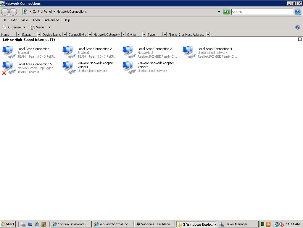

by: 03671328Posted on 2009-10-06 at 09:47:06ID: 25507074
when the cable are connected to the team each of the actual team members show a connected link
but the main team stays unconnected...
    • 69 KB
    shows you what im talking about.
by: Netman66Posted on 2009-10-06 at 10:13:59ID: 25507360
I think VMWare may be interfering with things.
I see 2 Intel NICs (Local Area Connection & Local Area Connection 2) which should be part of Local Area Connection 5.
Local Area Connection 3 and Local Area Connection 4 should not be part of the Team.
Use a physical NIC as the bridge when it installs - you may need to get the team working before the VMWare networking gets installed.
by: 03671328Posted on 2009-10-06 at 10:24:56ID: 25507469
um lol wow.... u unchecked vmware driver from both the intel cards and the team card and it now has a link. :).
by: Netman66Posted on 2009-10-06 at 10:53:45ID: 25507778
Excellent.
It's important to know all the variables - and I didn't until your screenshot.
Glad it's working now!
