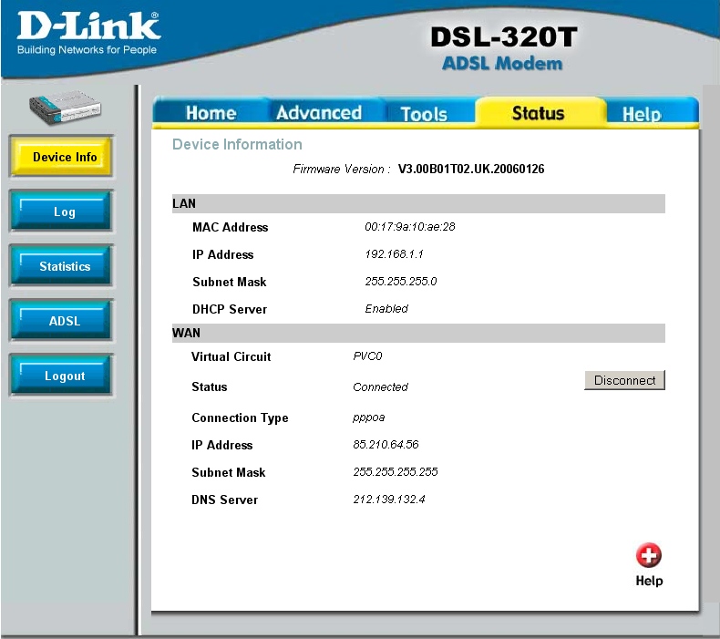

I should also state that whilst I have only just purchased the router, I have been using the modem to recieve the internet successfully for over 6 months. It has worked fine by either attaching it directly to a PC, or plugging it into an Apple Wireless Access Point (AirportExpress). In addition, the router seems to work fine when I access it either wirelessly or by ethernet cable. So far, I have had no problem accessing or changing the router's settings.

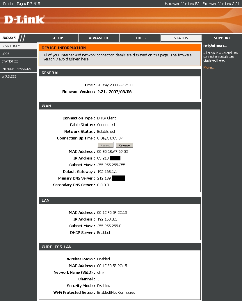

Here are the settings under the 'status' tab of my DIR-615 router:
WAN
Connection Type : DHCP Client
Cable Status : Connected
Network Status : Established
Connection Up Time : 0 Days, 0:01:58
MAC Address : 00:1B:24:1F:54:E6
IP Address : VALID PUBLIC IP ADDRESS
Subnet Mask : 255.255.255.255
Default Gateway : 192.168.1.1
Primary DNS Server : VALID PRIMARY DNS
Secondary DNS Server : 0.0.0.0
LAN
MAC Address : 00:1C:F0:5F:2C:15
IP Address : 192.168.0.1
Subnet Mask : 255.255.255.0
DHCP Server : Enabled
Other necessary information:

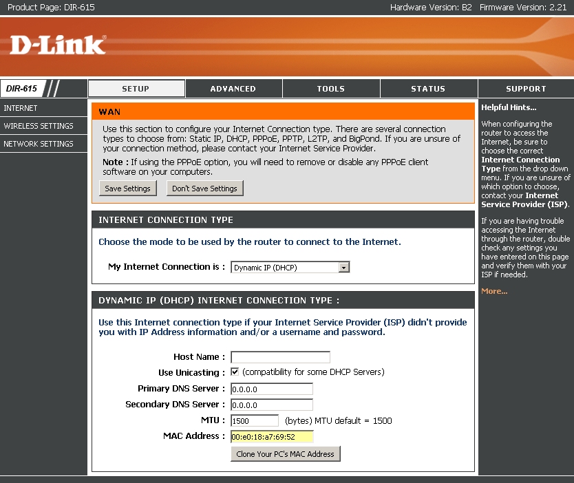

The above router status is based on setting the internet connection type in the router to 'Dynamic IP (DCHP)' and I have also put my ISP settings into the modem. I have not set the internet connection type to PPPoE on my router and entered my ISP's username and password directly into the router, as I have tried this and it did not work. However, as mentioned above, all the equipment shows that the internet is 'connected' when I put the ISP settings into the modem and enable 'Dynamic IP (DCHP)' on the router. Incidentally, the 'internet on' light on the router is lit up green constantly.
As far as both products are concerned, I have repeated the setup process a number of times, and have performed a factory reset before each attempt. I have also connected the modem to the router using the standard procedure of 1. plugging both out, 2. plugging the modem back in and 3. attaching the modem to the router when the ADSL light on the modem turns solid green. I have tried changing the modem's DCHP settings to 'do not assign DCHP to any attached devices' but this has not worked either.

Hi there, managed to solve the problem myself. This involved updating the firmware of the DSL 320T modem. This was quite surprising, given that these two D-link devices were sold as already compatible.
