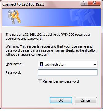

After a client made a VERY long password of 28 characters, the router will not allow logon with Administrator as username.  Client has tried everything possible to reset the router, but still no luck.  We are considering an exorcisim, but we figured there was a magic method to reseting an RVS4000 Router.

by: LucFPosted on 2009-03-26 at 12:05:02ID: 23993984
stlbridge,
Just looking at the screenshot... the default administator username is "admin" instead of "administator"
LucF
by: stlbridgePosted on 2009-03-26 at 12:21:12ID: 23994123
LOL.  Not that easy, I'm afraid.  Thanks for the suggestion. I had initially set it to administrator when I configured it.  I also set his ip range to 192.168.192.xxx  .  Just some silly tricks to keep the neighbors away, really.  Being the range never change back to the default 192.168.1.1, this is how I know it's not resetting.  I may just give it a good punt through the yard if it doesn't get resolved tonight!  I'm going out for a visit.
