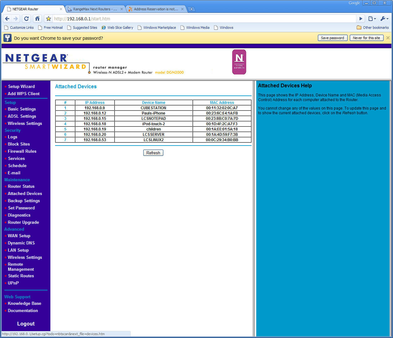

I've been using my new Netgear DGN2000 wireless modem/router for a couple of weeks now and have attempted to setup Address Reservation on the LAN web page.  I have a number of devices that connect but none of them are retaining their IP address when they are rebooted.  Even attempting a Windows Repair, in theory, should drop and reassign the IP address, but it isn't getting the pre-assigned address.  I can see the devices are attached and the MAC addresses are correct.
Any idea what is happening?  I had this working perfectly on my old Netgear DM602 modem, which unfortunately died after 5.5 years of use.
The firmware version is 1.1.1 and there don't appear to be any updates for the UK (only 1.3.7NA for North America).
Any pointers to get this working would be appreciated.
Note: I've attached a couple of screen dumps showing the IP Address Reservation setup (LAN-Setup.jpg) and the devices currently attached to the router (Attached-Devices.jpg).
If you look at, for example LCSSERVER, it has MAC address 00:1A:4D:59:F7:3B and should always be assigned IP address 192.168.0.2 according to the reservation table, however, it is attached as 192.168.0.20!  This is the same with other devices also.

by: MilleniumairePosted on 2009-08-23 at 05:19:16ID: 25162338
Having done further research on the way IP address reservation is used on the DGN2000 router I have now got it working.
I removed all reserved IP addresses and turned off all those devices that might attach to it.  I then turned on device one.  It was assigned IP address 192.168.0.2 using DHCP.  I then reserved this address by adding it to the IP address reservation table using the facility that shows attached devices and their MAC addresses.
I repeated this for each device in turn that I wanted to reserve and IP address.  For each device I turned on, it was allocated the next IP address e.g. 192.168.0.3, 192.168.0.4....
Having completed this I tried rebooting/disconnecting each device I had setup and everything works fine.  Each time a device starts and uses DHCP to retrieve an IP address, it looks up the reserved IP address from the address reservation table and assigns that.  For devices that I didn't set up it assigns the next IP address available "that isn't in the IP address reservation table".  The Netgear is still configured to use the IP range 192.168.0.2 to 192.168.0.254 for DHCP i.e. it "includes" the range of IP addresses setup in the address reservation table.

by: MilleniumairePosted on 2009-09-14 at 08:26:56ID: 25326433
After a while the address reservation started to "fail" again.  Note: It still wasn't necessary to setup any static IP addresses, the router controls and sets all IP addresses, it's just that some are reserved for use with specific machines and so don't get allocated as part of the "pool" of IP addresses.
This issue was resolved after contacting Netgear who have provided me with a newer version of the firmware.
