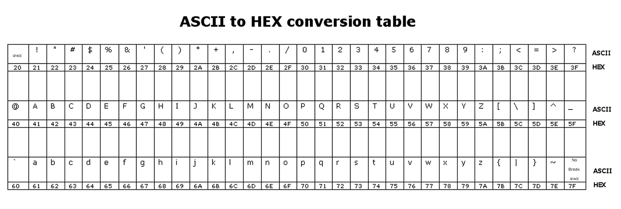

Try entering the passphrase in HEX instead of ASCII.
i.e. if the ASCII phrase is made up of the 96 characters commonly available on a keyboard, as shown in the chart below (click pn it to expand to 'full' size, though that's still pretty-small).

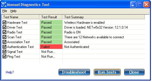

by: nina007Posted on 2009-09-30 at 19:34:38ID: 25465606
Ok so I uninstalled SP3 and rolled back to SP2, installed both updates http://support.microsoft.com/kb/893357
http://support.microsoft.com/kb/917021
and running on SP2 i still cannot connect to WPA2 networks.  I changed it from the intel manager to the windows manager to manage the wireless networks and neither could connect.
I can connect to WEP wireless networks but not WPA2. Does anyone else have any suggestions as this is driving me crazy!!
When i use the intel pro to manage wireless networks you can do additional troublshooting and it's erroring on authentication. see print screen.  However i am absolutely typing in the encryption key correctly.
thanks, Nina
