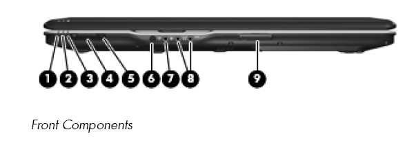

by: Darr247Posted on 2008-09-25 at 10:37:03ID: 22571921
So you push the button on the front edge, but it does not make the blue LED toggle on and off?
e.g. that would be items 4 and 5, respectively, in the attached diagram.
by: mruftPosted on 2008-09-25 at 14:17:15ID: 22573969
I appreciate your effort, but I know how to toggle the switch in front, if you read my question you would notice that the wireless adapter does not appear in the device manager at all and I have tried reloading the BIO's as well as installing new drivers all of which goes nowhere. The built in wireless is non existent, I have installed and tried USB 3rd party wireless adapters and they work fine. I have been all over the HP support site to no avail.
by: Darr247Posted on 2008-09-25 at 15:00:16ID: 22574328
I'm sorry you took offense, but I did peruse your question thoroughly.
I asked a yes or no question, with accompanying diagram so there would be no confusion about to what switch I was referring.
I failed to get an answer to it, so I'm unsubscribing now.
