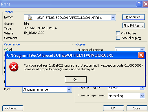

by: piotrmikula108Posted on 2009-06-18 at 16:30:53ID: 24662722
I get the error (screenshot attached) when trying to edit the prinitng preferences of the printer, I get that in all programs
by: hdhondtPosted on 2009-06-19 at 03:34:14ID: 24665126
I would completely reinstall the printer, as follows.
Go to the Printers & Faxes control panel. First delete the printer. then, from the File menu, select Server Properties. Click the Drivers tab and remove the printer from the list. Then reinstall the driver.
If you are printing via a server, do this on the server and then reinstall on the clients.

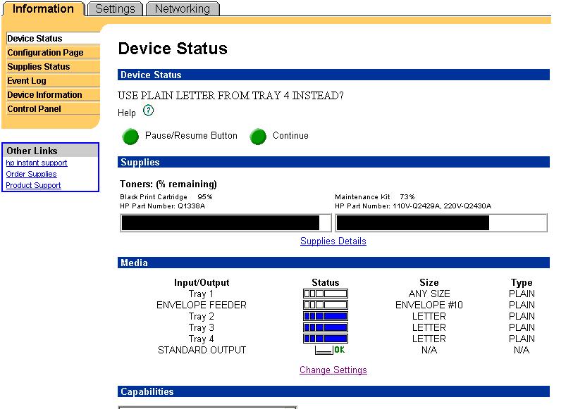

by: piotrmikula108Posted on 2009-06-19 at 12:35:36ID: 24669301
I updated the driver and no more errors, however still not getting anywehere prinitng from the eCopy program, see the webinterface status
thank you
by: hdhondtPosted on 2009-06-19 at 20:23:14ID: 24672052
You're going to have a look at eCopy itself, as the problem appears to be there. Does it have a menu entry like Page Setup or Print Setup (from the File menu)? Have a look and see if you can find a setting that selects the paper size, type and tray.
by: piotrmikula108Posted on 2009-06-19 at 20:44:59ID: 24672142
we found that it was one setting on the printer itself, we had to enable Override Paper Size settings, eCopy was forcing paper size that the printer couldn't handle and we didn't find an option in eCopy to disabled that so we did it on the printer
