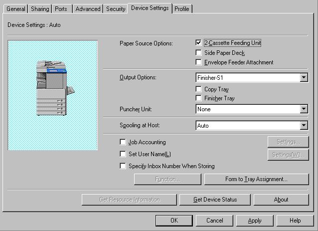

I have a bunch of Canon Multi Function Devices that have an option to "Get Device Status" by pushing a button when I am in the properties of the printer. I believe my networking section turned off the port that this feature uses. Does anyone know what the port number is that Canon uses for this function?

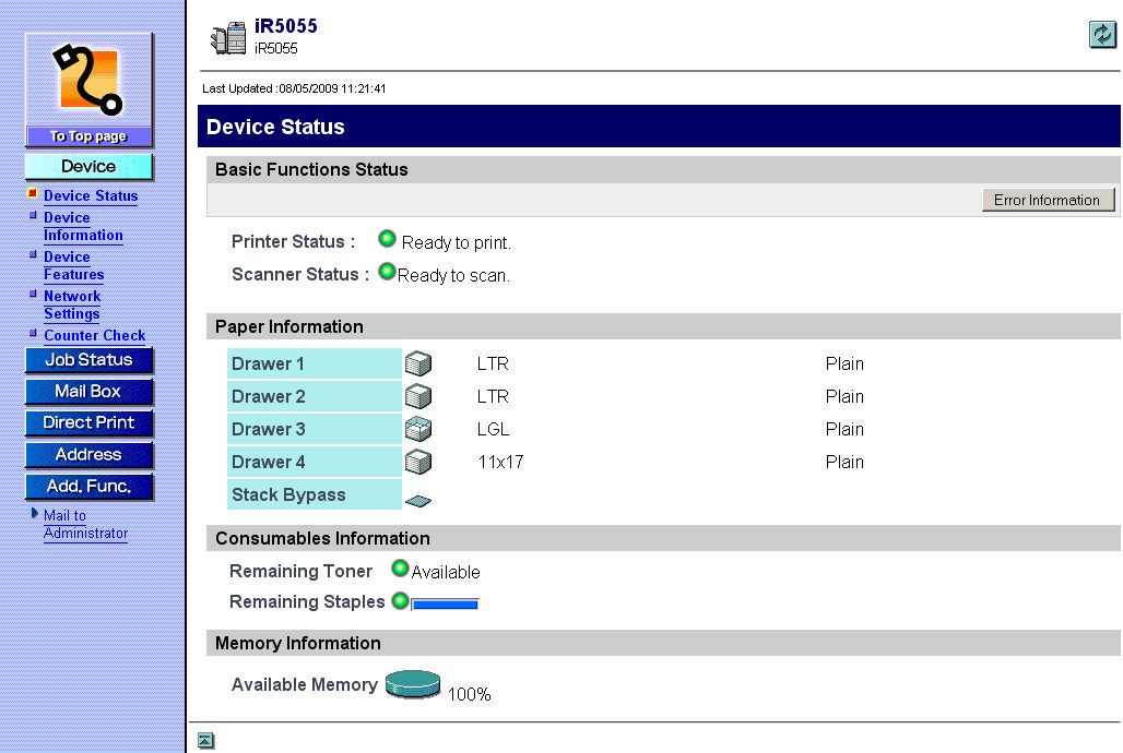

I have few iR5055 and I have no idea what you're looking for
you can browse \\Printername or \\PrinterIP and should get to the printer management page. no ports required

by: Symone1024Posted on 2009-08-05 at 08:28:14ID: 25024565
Sorry if that was to vauge. I am using Canon Image Runners. I have many different models.
i.e. iR  2270, 5870, 3025, 3035, 5055 ect.
The button I am refering to is under printer properties, device settings tab.  (note attached pic)  The button I am talking about is just above cancel .  "Get Device Status"
Thanks.
by: chukuPosted on 2009-08-05 at 08:35:22ID: 25024639
my iR5055 look totally different...
by: Symone1024Posted on 2009-08-05 at 08:37:16ID: 25024661
I see - You are going through the web interface. I am looking at the properties for the specific printer through the print server.
by: hatheharikenPosted on 2009-08-05 at 08:42:21ID: 25024726
@chuku, the image you posted comes from the browser pointed to your printer IP
Symone's picture comes from the printer properties dialog box.
@Symone, the iR series depends on the same ports 80+81 for status notification.
if you were to unlock these ports from your router (or get your sysad to do it) you would be successful in pinging your printer for status notifications.
cheers!
hathehariken.
by: Symone1024Posted on 2009-08-05 at 10:17:22ID: 25025706
I found it. The port these printers use is 47545.
Thanks all for your help.
by: hatheharikenPosted on 2009-08-05 at 11:21:22ID: 25026451
what revision is your fiery? that port is a recent development. if your printers are less than 1 years old then it is 47545
but if they are older, 80+81 are the correct ports.
just to be safe, it would be better to keep all three open.
