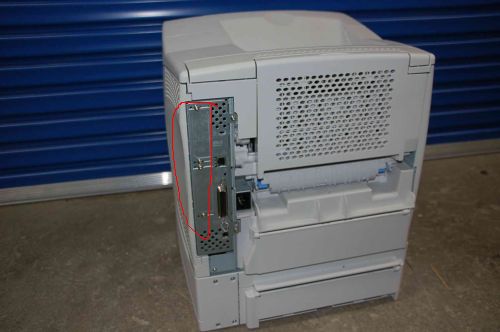

by: xxdcmastPosted on 2009-10-27 at 11:48:17ID: 25675971
If it had the wireless card it should be on the back of the machine. Where I have circled.
by: rgb192Posted on 2009-10-27 at 12:01:42ID: 25676100
yes there is a small 2 inch box coming out of the printer
how could I configure that wireless box

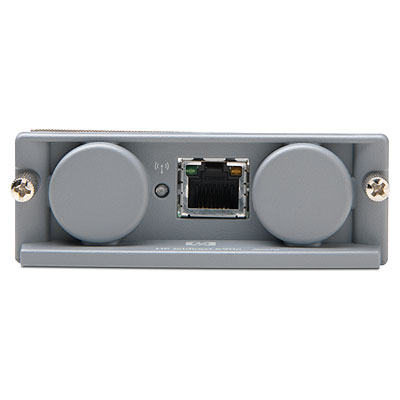

by: maximus5328Posted on 2009-10-27 at 12:42:49ID: 25676555
This is how wireless print server for LaserJet 4250n looks like. Looks familiar?
by: rgb192Posted on 2009-10-27 at 13:39:48ID: 25677183
does the 'wireless print server'  come attached to the printer
or is it an optional accessory
I cant seem to find it
by: xxdcmastPosted on 2009-10-27 at 13:42:35ID: 25677211
It might not even be there, in fact I would guess that it isnt there. It is an optional component. If they just ordered the base model you might only have the USB port. If that is the case you will need to do as mentioned earlier and share the printer through a computer.
by: b0lsc0ttPosted on 2009-10-27 at 14:10:26ID: 25677535
That printer does not come with the wireless card.  It is optional so would be an extra cost and install.  A 3rd party wireless hub or print server is probably your best option but you could purchase the option equipment the first expert mentioned from HP.
