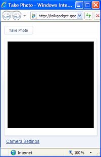

It does not appear to be Skype specific.  I tried for example the Google Talk gadget, clicked on my Google Talk picture, and selected the "Take Photo" option. The image from my webcam is black (see attached picture) even though the webcam camera LED comes on and goes off at the start and end of the attempt.
