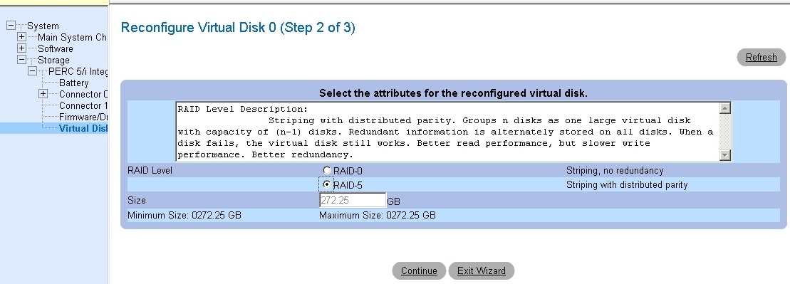

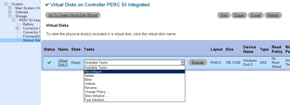

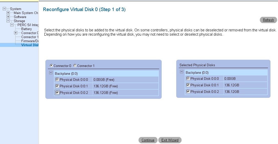

by: dmitry_moroPosted on 2009-01-10 at 03:08:51ID: 23343148
After updating the PERC firmware and driver to the latest one I've run Dell's OpenManage System Administrator and it turned out that single disk configuration is presented as RAID 0.
So I've installed the new disks and then run RAID Reconfiguration wizard, converting existing "single disk RAID 0" "to triple disk RAID 5". The process took about 3 hours for my 136 Gb disks and now I'm running RAID 5. No need to reinstall OS etc.
I've attached OpenManage screenshots with RAID reconfiguration wizard steps.
