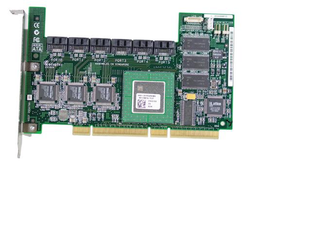

Thank you so much charlestasse I feel like I got the keys to my car and I'm about ready to drive it lol. I have one very stupid question on the motherboard there is a sata con1 and a sata con2 connection on the motherboard sata con1 is blue sata con2 is black. On my Cerc Sata card I have 1 blue connector and I have 5 black connector I'm I supposed to plug in hd0 to the first blue port on my cerc card and then hd1 to the next black port on the cerc card or I'm I supposed to put them on the motherboard like sata con1 to hdo
sata con2 to hd1. Thank you once again for helping me out.
by: charlestassePosted on 2009-08-31 at 11:45:07ID: 25225244
you need to connect each hard drive to each Sata port on the Cerc card starting at SATA Port 0. My pictures of the Cerc Sata 6 shows all ports on the card as black. See attached
