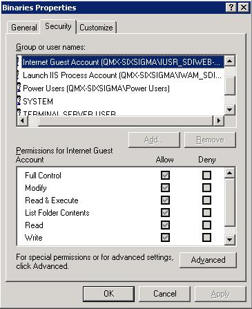

by: pankajghargePosted on 2009-04-23 at 22:39:47ID: 24221985
I have granted the full rights on following directory where MSSOAP30.dll and WISC30.dll resides.
C:\Program Files (x86)\Common Files\MSSoap\Binaries.
I have added rights for QMX-SIXSIGMA\IUSR_SDIWEB-STG2.
No Luck this time too....
    • 37 KB
    Snap shot of C:\Program Files (x86)\Common Files\MSSoap\Binaries folder where I have added the IUSER permissions.
by: Olaf_DoschkePosted on 2009-04-23 at 23:11:18ID: 24222120
How's authentication of webapp users of that asp script configured? Does IIS impersonate the client user? In that case it would perhaps be the easiest to grant access to everyone on these dlls.
What error do you get at all? Have you looked for more informations about the error in the windows event log?
Is this relevant? http://support.microsoft.com/kb/266621/en-us
I'd check permissions on the keys HKEY_CLASSES_ROOT\Interface and HKEY_CLASSES_ROOT\TypeLib anyway.
Bye, Olaf.
