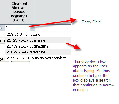

Hi, I am completely new to VFP and have been asked to look at some code that was written years ago and try to add drop down search capability. In this case it will be when a user starts typing in the product #, a box appears below the entry that lists all of the products that begin with the first entry, then narrow accordingly as the user types additional digits. I have included a .jpg of another application to show what I mean.
I know practically nothing about VFP 6 so the more detailed you could be the more helpful.

The control that you want is a Combobox in VFP-speak.
Set the IncrementalSearch property to .t. (true).
The above will partially satisfy your request by positioning the cursor on the item that most closely matches the typed characters.
To narrow the contents of the dropdown requires more code...

You will likely be better off going from scratch - mostly because of the rowsource and rowsourcetype properties that are required in the combobox and not present in the text box example. Certainly the code that you have attached will provide some pointers!
I have a class that I spent quite a bit of time on in the past that I will try to dig up a little later and pass along to you for your use and/or study. It does more of what you are after...

I got a combobox to work using the builder just to see how it would behave and as you said, it is not exactly as the users requested and it does not appear like it would work for us. Is there a way with coding that it could work exactly as I had hoped?
Another thought - what about a textbox as it stands now but with a pop-up list via a key-press, that could pass the selection to the text field?
