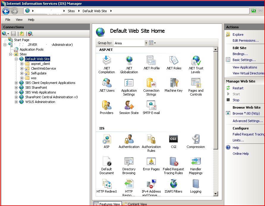

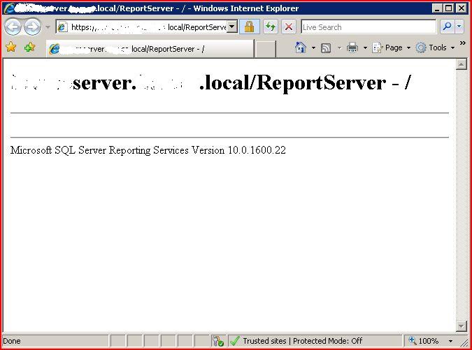

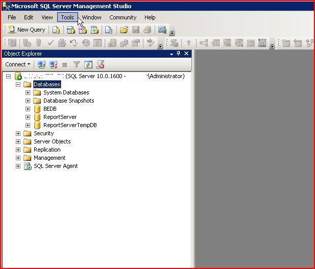

by: qwerty0Posted on 2009-02-09 at 04:16:14ID: 23589334
Hi
Thank you for your reply.
I uploaded some screen captures, hope they help...
There is no reportserver page under Default Web Site but reportserver seems to be working, at least after successful login reportserver page opens fine.
Best Regards
Mika
by: rakeshAgarwalPosted on 2009-02-09 at 04:25:35ID: 23589388
Hi
 I had same issue with one of our client. I created a virtual directory with reportserver pointing to reportserver folder << I dont remember exact path of report server forlder>> c:\programfiles\sqlserver\mssql1.0\sqlreportingservices\reportserver<<(hopefully this may be right>>
This will surely resolve this issue "The system cannot find the path specified".
regrads
Rakesh Agarwal
