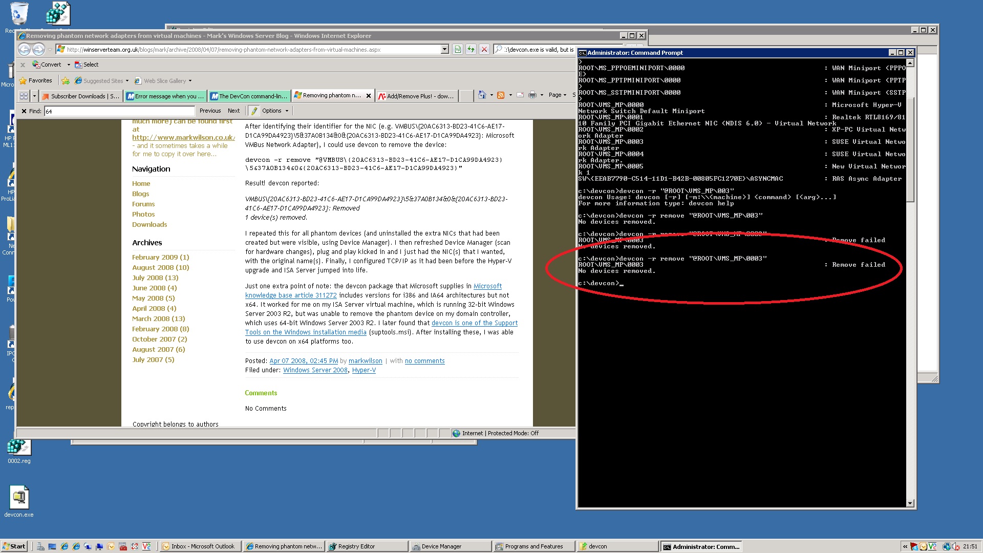

- Using http://support.microsoft.com/kb/269155 I tried removing using "Method 1" unfortunately with "method 1" even though I ran cmd.exe as an admin when I right click and un-install nothing actually seems to happen.
- When I try using "method 2" bizarrely the 64bit version of "DEVCON" produces the following when run...
"This version of C:\devcon\devcon.exe is not compatible with the version of Window
s you're running. Check your computer's system information to see whether you n
eed a x86 (32-bit) or x64 (64-bit) version of the program, and then contact the
software publisher."
And although I can get the 32bit version to work if I try to run the command to remove the unwanted virtual NIC I get a failure message (see attached).  Would someone kindly take a look at my syntax I probably screwed up :(

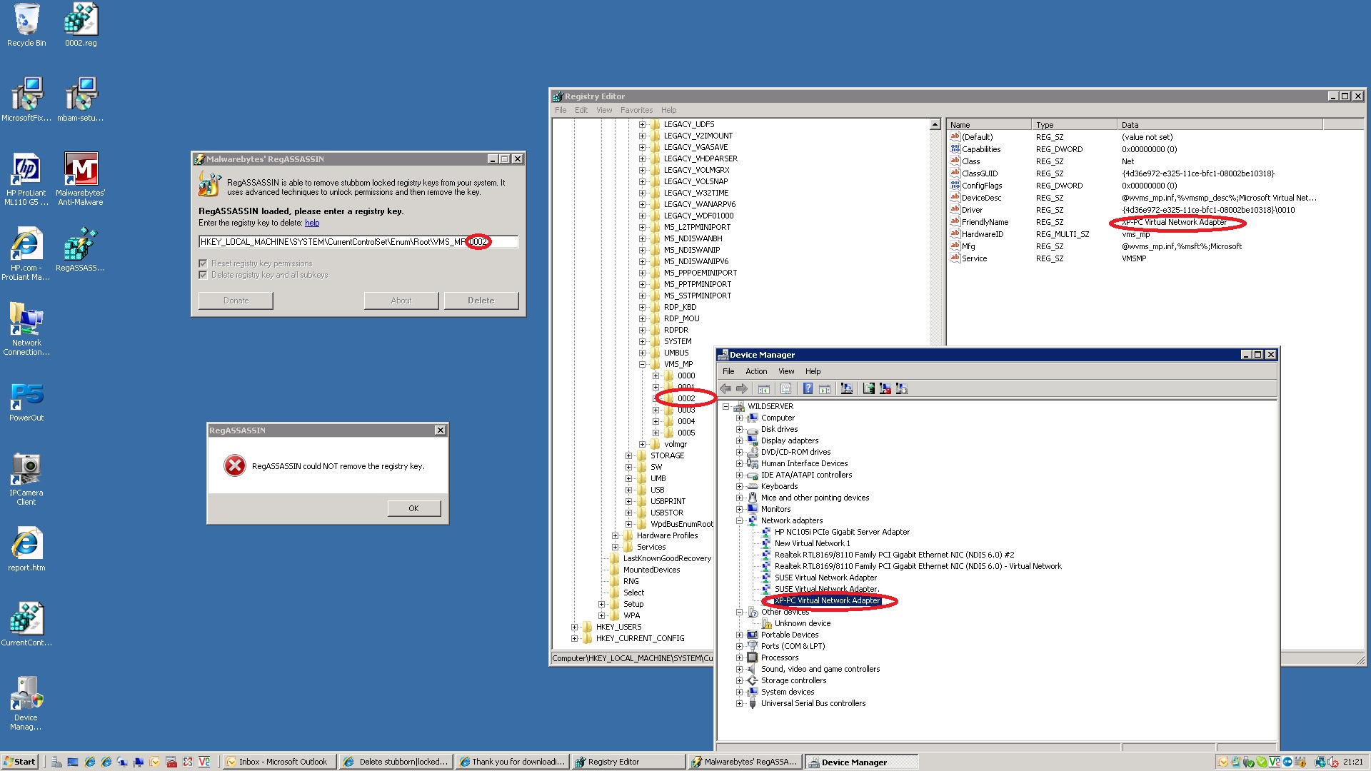

I decided to be brave and attempt to find the registry entry and delete it.  I searched for the Phantom Virtual NIC's friendly name within the registry and attempted to delete that key.  It was simply impossible even after granted everyone full control in the permissions.  I even tried using Malware Bytes RegASSasin which apparently can remove stubborn registry keys.  I am starting to think this may be the root cause of the problem, can anyone advise?
See Screen shot attached
by: lukeglazebrookPosted on 2009-10-05 at 13:31:06ID: 25499379
Reg Screenshot

I downloaded Server 2003 R2 specifically to ensure I was using a 64bit compatible version of Devcon (think I was anyhow).  Unfortunately whenever I try to run the suggested commands I receive the following error (see screenshot).
Any ideas?  I believe devcon simply removes the registry entries I have already located.  Unfortunately however I can't take ownership of them and delete them manually either.
by: lukeglazebrookPosted on 2009-10-07 at 14:00:51ID: 25520019

 - I am unable to remove any known Virtual NICS using the Devcon I have (it simply responds with the above error)

Yep been through the registry and I am fairly sure I have located what needs to be deleted.  However the problem is I cant delete the entries, this may even be the reason devcon cant uninstall the drivers?  And unfortuately I cant take ownership of or changes the permissions on the registry entries either, it wont let me.  I am assuming the current owner is "SYSTEM" ?
