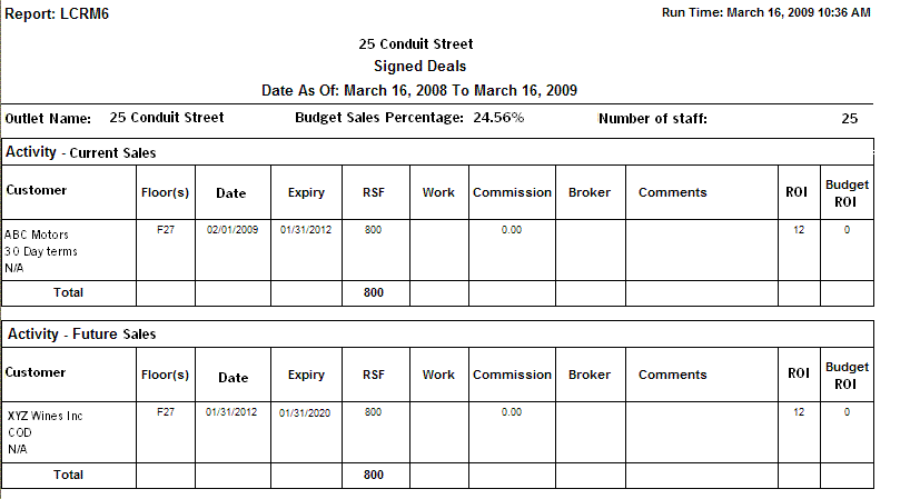

by: lilycollinsPosted on 2009-03-16 at 08:50:40ID: 23899109
Here you go.  Thank you.
So to summarize.  When I use a table grouped on Outlet name.  I would get all the current sales listed under 25 Conduit Street, not just the ones for 25 Conduit Street.  The nested tables are in the footer of the container table that has the Outlet Name, Budget Sales Percentage and Number of Staff as the group header for the containing table.
by: TheLearnedOnePosted on 2009-03-16 at 12:11:41ID: 23901225
That is a good picture, but I would prefer one of how it is in the designer, and not the rendered output.
