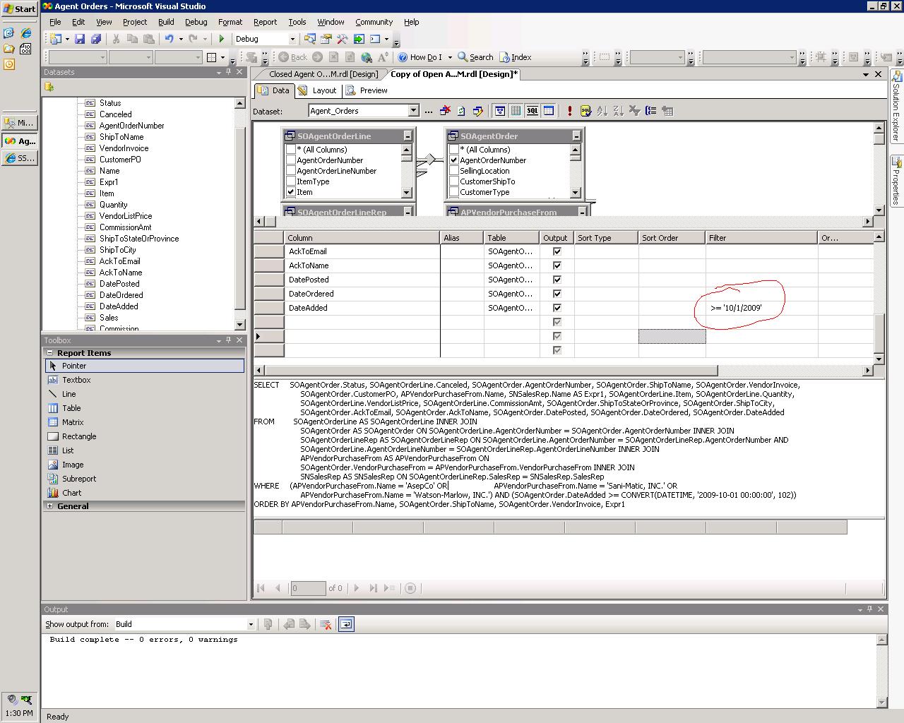

I am looking to filter for Current month.  I know how to do last 30 days getdate() -30
But how do I do it  from the beginning of the month to current day
it also has a time stamp so i want to make sure
WHERE     (SOAgentOrder.DateAdded >= CONVERT(DATETIME, '2009-10-01 00:00:00', 102))

I did try it out not returning the same numbers   I am using a static filter now.   for current month
