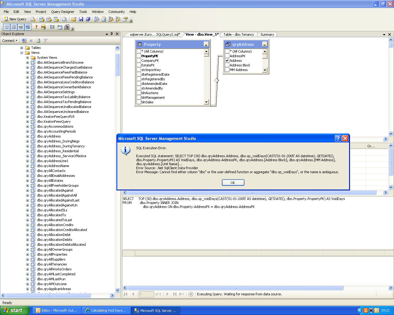

Hi pcelba
I have added the procedure and created a query to retrieve some info but get an error..  attached jpg shows it..  The procedure was stored in the right database but I am not sure what to look for to correct it..  sorry but I am a novice of sorts to procedures..

by: pcelbaPosted on 2009-10-29 at 03:34:43ID: 25692132
If you want to use the code in a SELECT statement then you have to define it as a function (update the function name to whatever you want):
CREATE FUNCTION [dbo].[fn_voidDays] (
      @DateFrom datetime,
      @DateTo datetime,
      @PropertyID uniqueidentifier  )
RETURNS int

by: DelboyPosted on 2009-10-29 at 05:53:46ID: 25693033
Hi pcelba..
I get this error creating the function :(
Msg 443, Level 16, State 15, Procedure fn_voidDays, Line 8
Invalid use of side-effecting or time-dependent operator in 'SET OPTION ON' within a function.
by: DelboyPosted on 2009-10-29 at 05:56:17ID: 25693059
I removed the set nocount on option and it works..  is this ok to do?
by: DelboyPosted on 2009-10-29 at 06:22:05ID: 25693311
It is working a treat without it..  I will wait for your comments and accept your fab answer, and thanks for it..  very clever..

by: pcelbaPosted on 2009-10-29 at 08:29:04ID: 25694779
Yes, SET NOCOUNT ON must be removed from he function. I just forgot it there when converting SP code.
