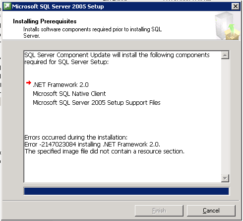

BTW - I've also attached a screen shot of the error to this post.
Thanks.
by: crmsharepointPosted on 2009-11-30 at 04:06:33ID: 25933204
Not sure if the image made it through.  Re-attaching here.
by: crmsharepointPosted on 2009-11-30 at 04:08:21ID: 25933220
As you see the error is:
Errors occurred during the installation.
Error -2147023084 installing .NET Framework 2.0.
The specified image file did not contain a resource section.
Thanks in advance.
