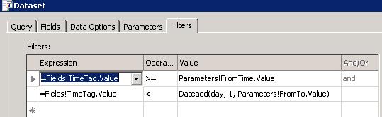

I'm using Business Intelligence Development Studio in Visual Studio 2005 environment.
When I preview a report with the parameter dates of 7/3/08 to 7/3/08 I get no results.
When I use dates of 7/3/08 to 7/4/08 I get 5 records dated 7/3/08.  Because of help from EE I understand why it's happening but need help with the code.  I've attached what it should be logically but I get the error...
Cannot compare data of types System.DateTime and System.String

by: simonetPosted on 2008-09-17 at 09:51:48ID: 22500873
That's because the Datetime fields contains a decimal part that holds the hour/minute/second part of the date.
When comparing dates, if you're interested only in the date part (regardless of the time part), you can have a where clause like this:
WHERE (cast(cast(SomeDateField as int) as datetime) = '3 JUL 2008')
if you want to compare intervals of time:
WHERE (cast(cast(SomeDateField as int) as datetime) between '3 JUL 2008' and '07 JUL 2008')
This will yield correct results.
In short, what you need to do when comparing dates, is force SQL Server to ignore the time component of the datetime field, so that the comparisions are accurate.
Alex

by: BobRosasPosted on 2008-09-19 at 09:28:32ID: 31497406
Adding this parameter and taking out the filters is what got me wher I need to be.  Thanks
by: BrandonGalderisiPosted on 2008-09-19 at 09:36:07ID: 22522963
You are filtering by date in the very first section, which is limiting the amount of data returned and making it faster.
by: BobRosasPosted on 2008-09-19 at 10:13:22ID: 22523289
Makes sense.
