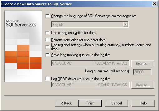

Does the encryption have to be on?
If not, it sounds like an ODBC call was setup with the Use strong encryption turned on. Try turning it off and see what happens.

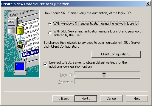

In looking at it it looks like I can't get it to connect so I can't get it to the screen with the encryption setting. Looks like I am having an issue with sql verifying the authenticity of the login ID to begin with any Ideas on that? using network administrator account and password and have all last year
the error code I get is:
sql state: '08001'
sql server error 21
by: jimpenPosted on 2009-08-28 at 09:01:48ID: 25209013
Turn off the check box for connect to server -- then try getting to the next page(s).
