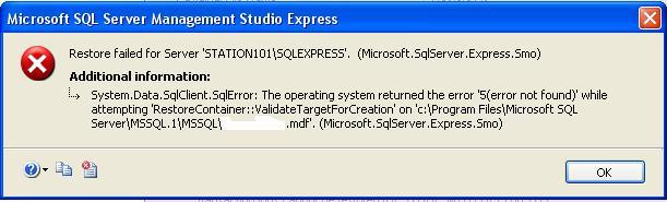

Hi, I have taken a MS SQL 2000 database in file that doesn't have .mdf extension. I gave the .mdf extension and I began the attach procedure but I had an error message. Then I tried a restore procedure but If I understood right you can restore a database only if you had previously taken a back up and I do not know if this file is a backup file. What can I do?

rename it to have extension .bak and try restoring instead of ataching

I have found that the file name says "...Full_BackUp". Therefore it is not an .mdf file but a backup file. How can I restore a database backup file that have been taken from another system in my system?
by: nonlinearlyPosted on 2009-11-05 at 10:28:45ID: 25752358
I have only one file and the Sql Server has only restore options about databases that are already in the system.
by: nonlinearlyPosted on 2009-11-05 at 11:01:48ID: 25752718
Ok I made this steps exactly as the "aneeshattingal" link said but I take an error when it start the restore. See the attachement.
by: nonlinearlyPosted on 2009-11-05 at 11:25:14ID: 31650638
This solution help me but it did not mention that first has to create the database and second to restore. thanks anyway
