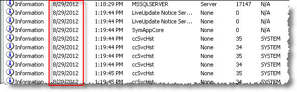

by: ksfokPosted on 2009-10-30 at 15:58:26ID: 25707305
I  am afraid my event viewer got messed up, Please see attached file and advise.

by: geek_vjPosted on 2009-10-31 at 06:27:15ID: 25709677
From the event vwr image, it looks like your windows time is incorrect. Please try resetting your system time to the current time to get the exact error messages in event viewer.

by: rrjegan17Posted on 2009-10-31 at 06:40:56ID: 25709715
It didn't list any error message and contains only informational messages.
