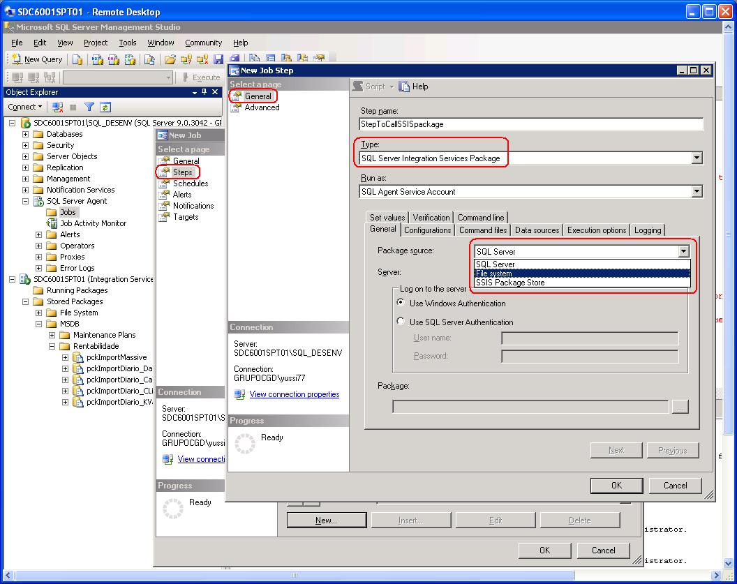

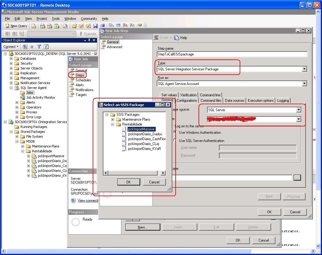

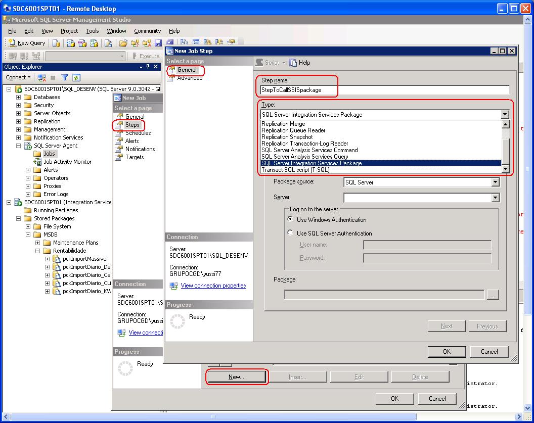

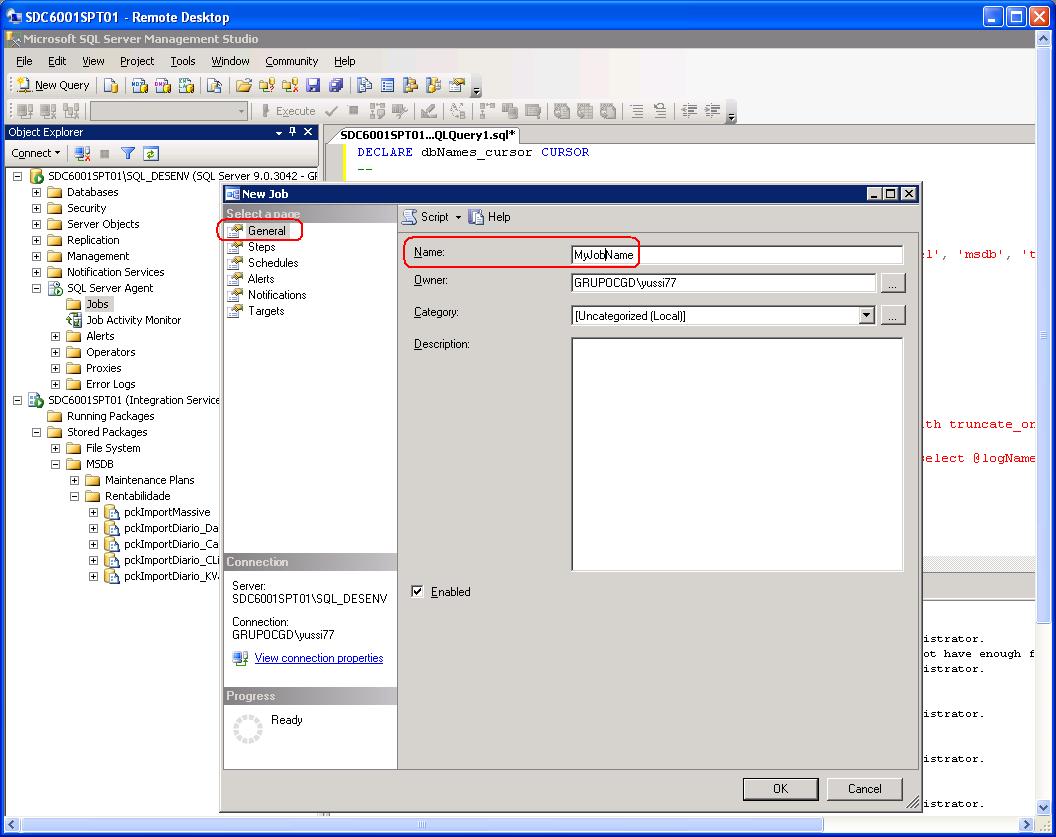

Hi Thanks for the solution, its Working fine..I have one more doubt regarding Executing these packages using SQL Agent by creating a job. When I tried creating these jobs Some how its not taking. Can you please tell me How I can Execute these packages by setting up a job in Sql Agent.
by: PedroCGDPosted on 2009-03-04 at 04:01:04ID: 23793838
Follow the attached images.
