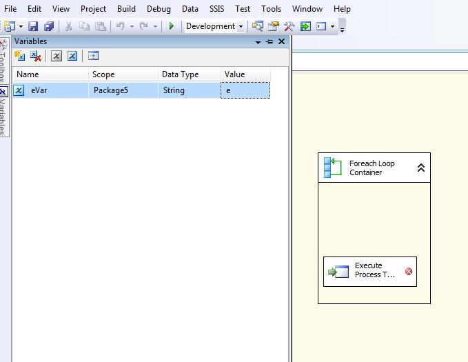

by: reza_radPosted on 2009-11-04 at 21:34:18ID: 25747008
set it as default,
create a new variable as eVar in package scope
as type string
with value e
by: TheCommunicatorPosted on 2009-11-04 at 21:34:40ID: 25747010
I mean I have only defined variables through For each loop file enumerator only so I am not sure how to assign a character value to an SSIS variable
by: reza_radPosted on 2009-11-04 at 21:38:07ID: 25747019
look at attachment

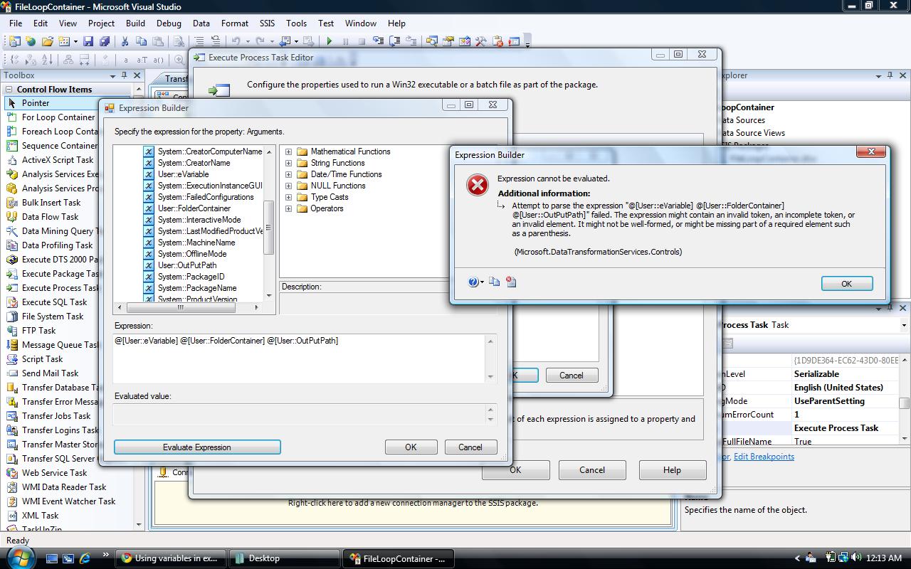

How did you open that window which you attached in the previous post? I am using VS 2008 and assumed that you are using 2005 thats why it looks little different. I did stick to the notion that  in this case, I can define variables in For each loop file container only.( If I am not assuming it wrong). I tried opening Package Explorer-->variables folder and tried to define a variable there but realized that its a place where you can just view them NOT define them.
Now, I have three variables in For each file loop container which contains my execute process task:
@[User::eVariable]--> Contains sole value 'e'
@[User::FolderContainer] --> No value defined and assuming that it will be by  default bound to what folder location I have defined in the collections tab.
@[User::OutPutPath]--> Location of the folder where the files have to be extracted. ( I am specifying this value manually as a string and contains value 'C:\Output'
Now, when I do
 Expressions--> Arguments=@[User::eVariable] @[User::FolderContainer] @[User::OutPutPath]
and press OK or "evaluate expression then it gives me following error:
" Expression can not be evaluated"
I told you this whole long process I suspect I might be making mistake somewhere else.
by: TheCommunicatorPosted on 2009-11-05 at 00:15:18ID: 25747536
I am attaching a snapshot for your review
by: reza_radPosted on 2009-11-05 at 01:17:28ID: 25747793
write this and then evaluate:
@[User::eVariable]+" "+@[User::FolderContainer]+" "+@[User::OutPutPath]

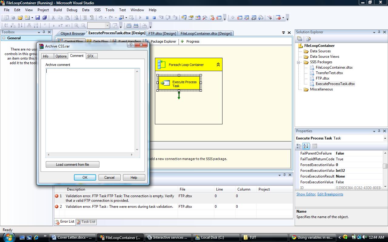

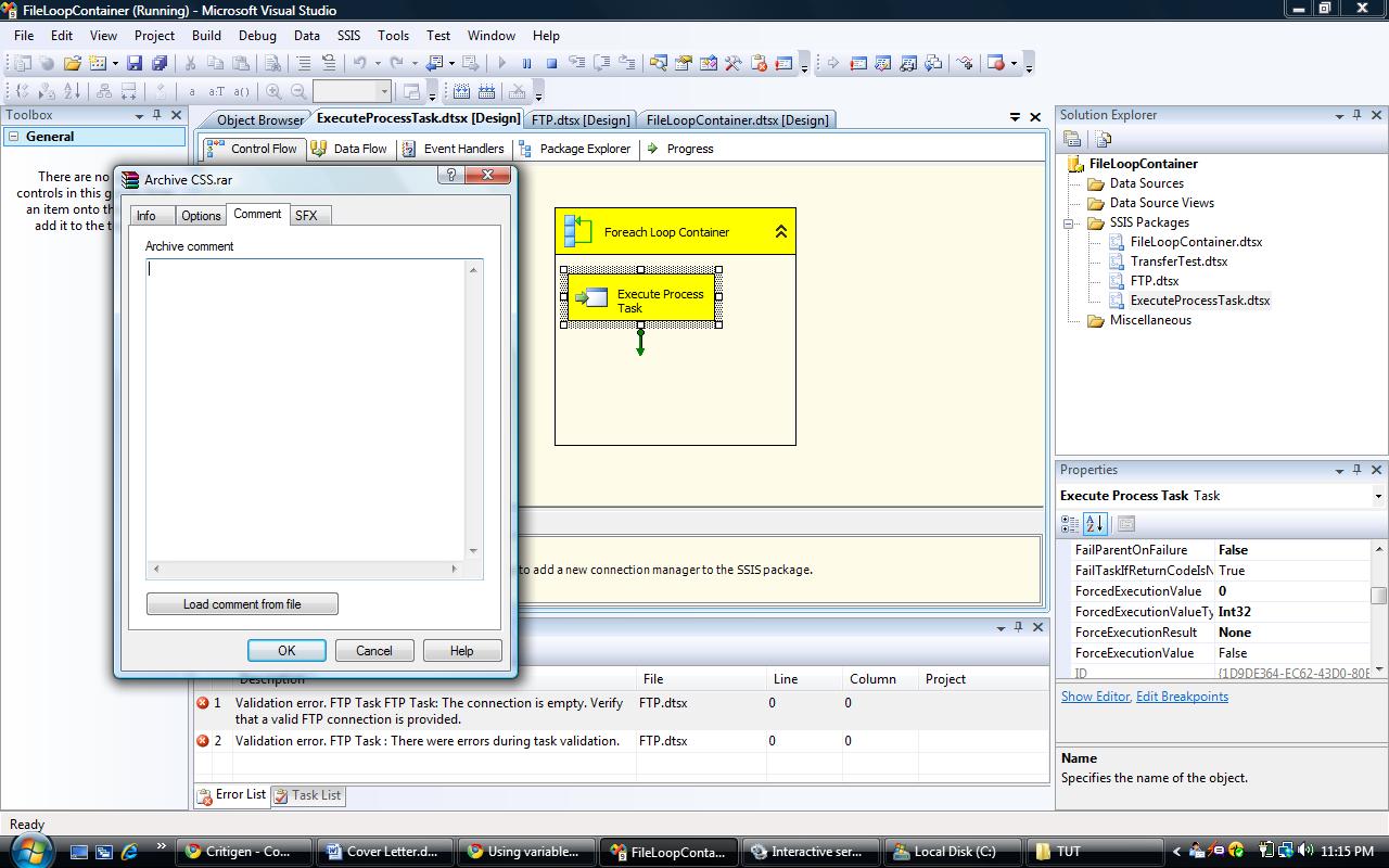

by: TheCommunicatorPosted on 2009-11-06 at 15:25:15ID: 25763972
Well, it opens a Decalogue box called "Archive CSS.rar, where CSS.rar is the file which is being  worked upon.It has four tabs 1. Info 2. options 3. Comments 4. stx  and here comments tab is automatically selected.
Along with that there is a button called "Load comments file" and  field called achieve comment.
by: TheCommunicatorPosted on 2009-11-06 at 15:47:40ID: 25764095
One more thing when I click cancel then it goes away without doing its job  but when I click on by entering any random comment then it gives me following error:
!   Cannot create __rar_00.789
!   Access is denied.
by: reza_radPosted on 2009-11-06 at 21:21:14ID: 25765099
This seems that you used rar command instead of unrar
am i right?
