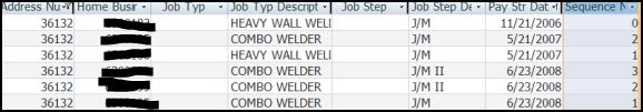

Hi I need to return the latest Job Typ Description and Job Step Desc in an access query based on the Pay Str Date and the sequence number. So looking at the attacment data i should be returning Combo Welder, J/M II. I have a partial query below but i can not figure out how to return the info i need.
SELECT tblEMPData.Number, tblEMPData.Surname, tblEMPData.Name, tblEMPData.Status, tblEMPData.Site, tblEmpProjectHistory.[Job Typ Description 1], tblEmpProjectHistory.[Job Step Description 1], tblEmpProjectHistory.[Sequence Number]
FROM tblEMPData LEFT JOIN (SELECT A.[Address Number], A.[Job Typ Description 1], A.[Job Step Description 1], A.[Sequence Number]
FROM tblEmpProjectHistory as A
WHERE A.[Pay Str Date] = (SELECT Max(B.[Pay Str Date]) FROM tblEmpProjectHistory B WHERE B.[Address Number] = A.[Address Number]))  AS tblEmpProjectHistory ON tblEMPData.[Number] = tblEmpProjectHistory.[Address Number]
ORDER BY tblEMPData.Surname, tblEMPData.Name;

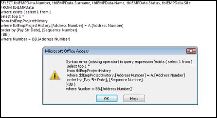

by: toni_Posted on 2009-01-24 at 18:41:39ID: 23459374
thanks for the reply. I am getting a syntax error and am not sure where the error is(i have tried placing another parenthesis right before BB). But just to be clear, i am doing a left join because an employee may not have any information in employee history. I need the most recent .Job Typ Description 1 and Job Step Description 1 for an employee found in the tblEmpProjectHistory - my issue is that both the date and the sequence number determine the most recent entry in tblEmpProjectHistory- I know i have done this a long time ago but somehow i just can not figure out the syntax

by: toni_Posted on 2009-01-24 at 18:49:14ID: 23459390
still get an error as attached
