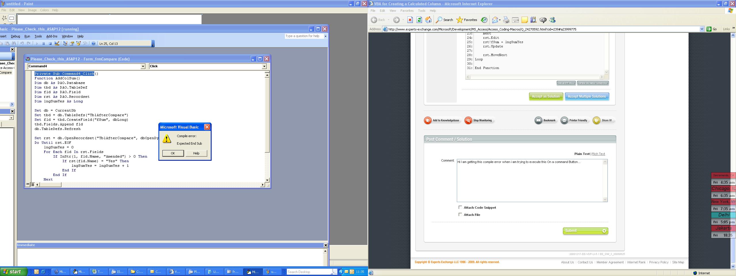

Hi Natchiket:
I am getting this compile error when i am trying to execute this On a command Button...
by: NatchiketPosted on 2009-03-27 at 04:43:33ID: 23999857
It's because the function declaration immediately follows the sub declaration.  Delete the line 'Function AddColSum()'
Also there will be a line near the end that says 'End Function', you need to delete that too
