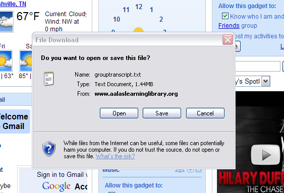

I modified some code provided by ChuckWood to open a URL using VBA from Access. If I click on this URL, IE opens and a Open/Save/Cancel dialog displays. I can press the tab key 3 times to set focus on the Save Key and press enter to open a Save dialog. When I try to duplicate this with "SendKeys", it does not work. Is there a better way to go about this?

is it because the sendkeys would effect the IE standard page not the open/save dialog which is opened as modal?
Maybe there is some way to handle the modal dialogue form...?

Thanks for the suggestion. I'll look into it this morning. But just to be clear, I'm not trying to save a web page, I'm trying to downlaod a text document. I can't provide the link because the txt file is confidential. To help communicate this, I am attaching a screen capture. I entered the URL from my home page (google) and you see the dialog that pops up while the web page is loading. My browser never navigates away from Google, it just presents the dialog and I can save the file.

by: NashVegasPosted on 2009-09-04 at 08:05:32ID: 25260377
Sudonim,
What this code does is download the shtml document. It navigates to "http://chaoticage.com/age_51.shtml" and saves this web page as "DownloadedFile.shtml". The URL I am using is not a link to an html document. It is a link that executes an asp script that presents the user with the Save dialog to download a specific txt file. The URL does not end in ".htm" or ".html" or ".shtml". It ends in "-08C7CC2383B58299". At this point, I do not know if I can get access to this file via ftp from the vendor. I am just working with what my internal customer has given me to work with. So I am hoping to find a way to interact with the form that opens from the URL. Is there a better zone for this question?

i do not think its possible to do what you want as it stands...I certainly do not know of a way to take control of the file save dialogue box which IE calls when it tries to save the file.

Sudonim, thanks for all of your effort. I apologize that I did not explain the situation very well. I thought I had made it clear that I was not trying to save the web page, but trying to interact with the file download dialog. In my original question I said "If I click on this URL, IE opens and an Open/Save/Cancel dialog displays." And in my first follow up, I said "But just to be clear, I'm not trying to save a web page, I'm trying to downlaod a text document." then provided screenshots that illustrate how the browser does not open to a web page but only presents the dialog. I hate that you wasted your time.
I've spent a good deal of time with the last link you provided. I'm getting closer. This link has also been helpful: http://vba-corner.livejournal.com/4623.html.  I've been able to get sendkeys to work, but not reliably. Anyway, I'll close this for now and when I get a little closer I may revise the question.
