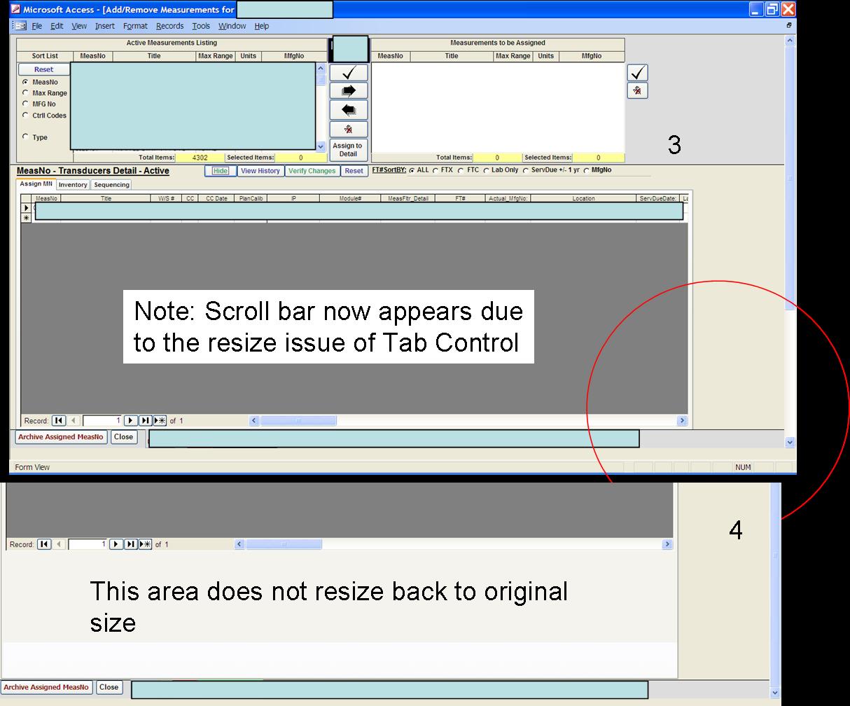

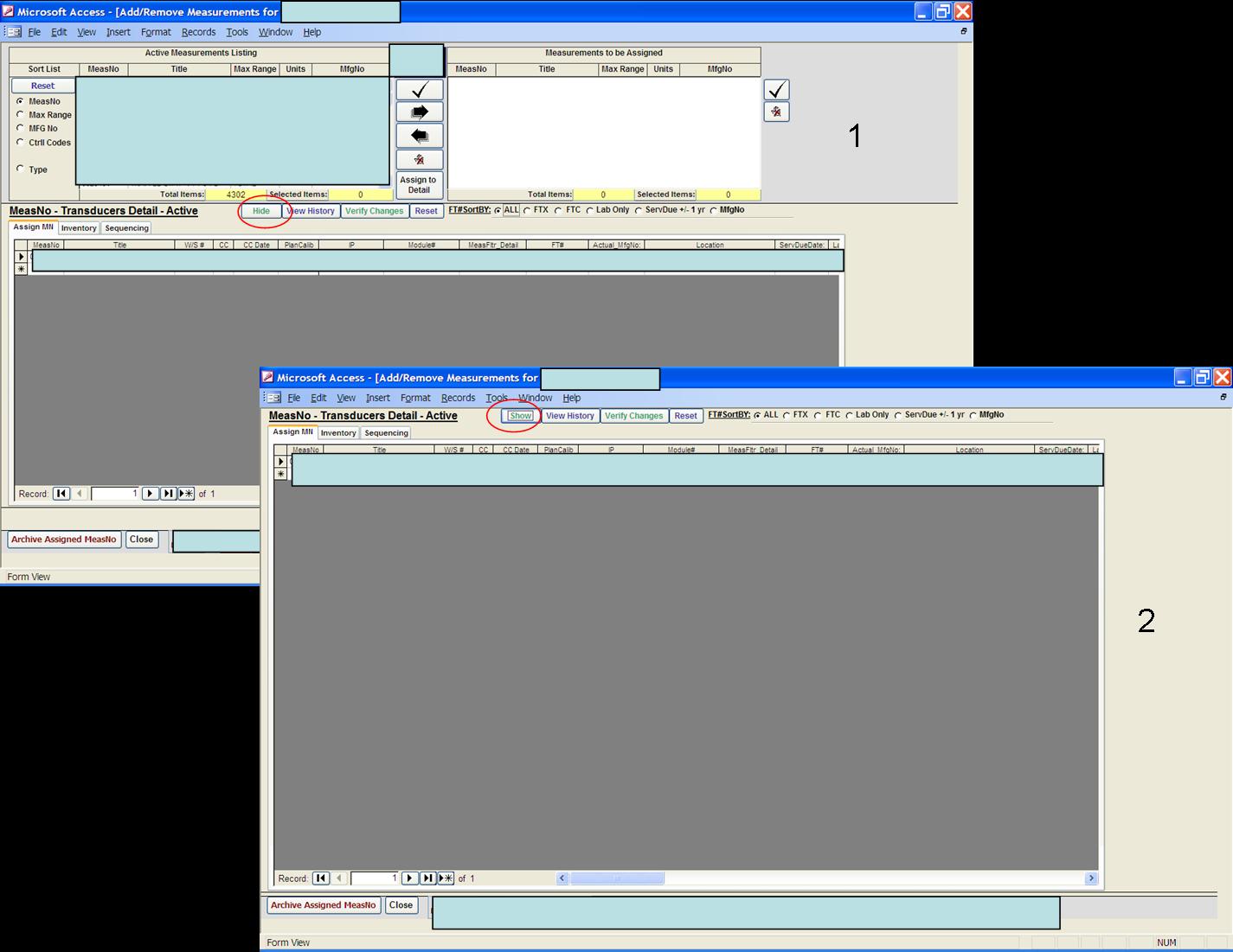

I need to resize a form to fit a Laptop screen - I also have a button that hides and shows the header of the form.  The form contains multiple subforms and a Tab Pages.  I am able to resize and hide the header, except when I try to reset the form to display the Header the tab Pages size will not change to the correct setting. See '<<<<<<<
The screen resolution is set to 1024X768.
When I step thru the code the Me.TabSub height = 7980 when I need it rest to fit the 1024X768 screen the Detail section is approx 3-4 inches.
Do you know when it will not reset?
K
Private Sub cmdShowHdr_Click()
  DoCmd.Maximize
    Me.Section(acHeader).Visible = Not Me.Section(acHeader).Visible
    If Me.Section(acHeader).Visible = True Then
        Me.SUB1.Height = 4200
        Me.TabSub.Height = 4320'<<<<<<<
        Me.Sub2.Height = 4200
        Me.Sub3.Height = 4200
        Me.sub4.Height = 4200 '7400
        Me.cmdShowHdr.Caption = "Hide"
    Else
        Me.SUB1.Height = 7400 '11500
        Me.TabSub.Height = 7300
        Me.Sub2.Height = 7400 '11500
        Me.Sub3.Height = 7400 '11500
        Me.sub4.Height = 7400 '11500
        Me.cmdShowHdr.Caption = "Show"
    End If
End Sub

by: boag2000Posted on 2009-08-15 at 21:09:06ID: 25107766
You can certainly buy a screen resizer to resize the form.
But this is not the solution in all cases.
We can't really diagnose a "Graphical" issue buy seeing the code.
Can you post a screenshot of this form in a Normal screen as it fits OK in.
Then post a screenshot of this form on the Laptop as it does not fit in.
There may very well be a way to design the form so it does fit.

by: kfschaefer1Posted on 2009-08-16 at 08:26:27ID: 25109254
How do I reset the size depending of the screen resolution - The difference from a External Monitor and a laptop monitor?
Thanks for code, however, this is only part of what I am looking for.
I am still need a solution for the hide/show of the Form Header and the resizing of objects (Tab Page) from tall to small based on whether the header is visible.
Here are some screen shots
1.  Show screen before :Hiding header- note size of Tab Control.
2.  On Click of HIDE button - Header is hidden and the Tab Control is resized correctly
3.  On Click of Show button - Header is visible, sub forms reisze correctly, however the Tab Control does not resize correctly - Note the scroll bar to the right, indicating there is more to see then what is on the screen.
4.  Tab Control remains the larger size.
It is number 4 I am having issue with why won't the Tab control resize.

by: kfschaefer1Posted on 2009-08-17 at 13:47:41ID: 25118248
I got my answer and it was so simple,  thanks Jeff for the assistance.
Solution:
The height of a tab page can't be less than the tallest subform. It appears you are trying to change the size of the page first, then change the height of the various subforms. I suggest you change all the subforms first, and then adjust the size of the tab page.
